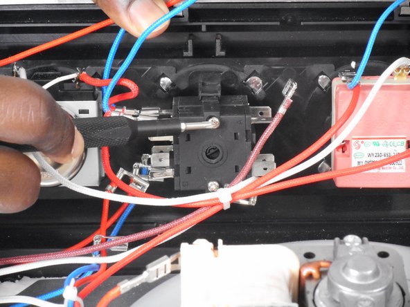

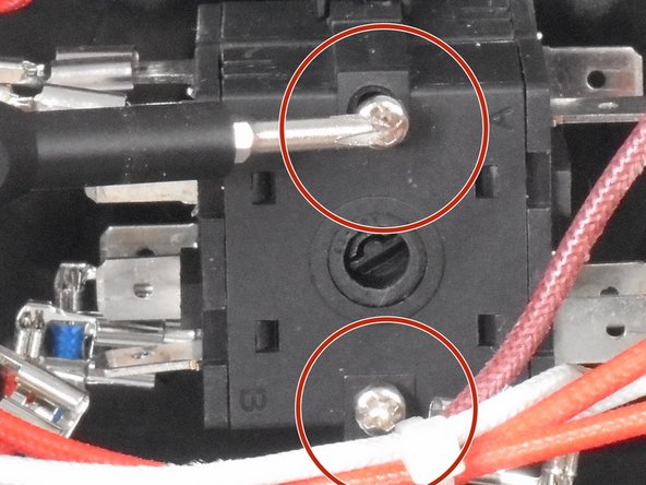

  6. Cuisinart TOA-60FR Function Switch Replacement, Function Switch: crwdns2935265:06crwdnd2935265:01crwdnd2935265:03crwdne2935265:0 Cuisinart TOA-60FR Function Switch Replacement, Function Switch: crwdns2935265:06crwdnd2935265:02crwdnd2935265:03crwdne2935265:0 Cuisinart TOA-60FR Function Switch Replacement, Function Switch: crwdns2935265:06crwdnd2935265:03crwdnd2935265:03crwdne2935265:0
    • Inside of the device locate the function switch and remove the indicated screws (4.97mm).
  7. Cuisinart TOA-60FR Function Switch Replacement: crwdns2935265:07crwdnd2935265:01crwdnd2935265:01crwdne2935265:0
    • Unclip all connections.

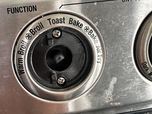

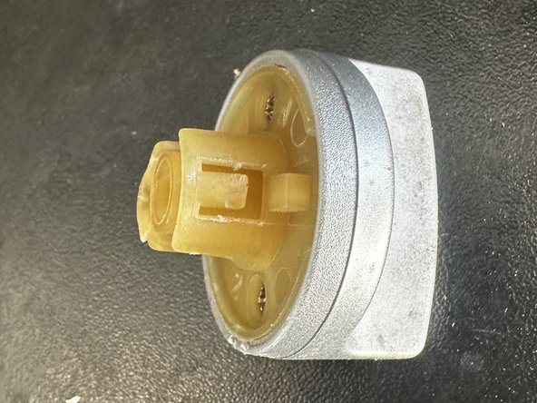

    • Rotate function knob to broil so plastic tab is visible when looking from the inside between the switch and control panel. Use screwdriver to push tab down and pull knob out from front side.
    • Remove 2 screws revealed under the front knob

Anyone have a source for a replacement switch?
Josh - crwdns2934203:0crwdne2934203:0
I ordered mine on Amazon
Martin Baumeister -
Big thanks for providing these instructions! It worked!
Martin Baumeister - crwdns2934203:0crwdne2934203:0
Thanks for the guide. Saved me the headache of having to find a new toaster oven and paying for it.
For those needing it, the part I ordered and used is part model number FZ31-9E (11 pins 7 positions) from amazon.
The switch will also have letters and numbers corresponding to the orientation as in step 6 so keep an eye out for that!

Part of Step 8...Difficult to understand picture how to remove knob on switch? i did follow up instruction that i didn't clear instruction if you have any video how to remove knob from panel switch?
Thanks Todd
