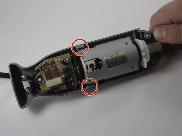

  3. Cuisinart Smart Stick CSB-75 Motor Replacement: crwdns2935265:03crwdnd2935265:01crwdnd2935265:03crwdne2935265:0 Cuisinart Smart Stick CSB-75 Motor Replacement: crwdns2935265:03crwdnd2935265:02crwdnd2935265:03crwdne2935265:0 Cuisinart Smart Stick CSB-75 Motor Replacement: crwdns2935265:03crwdnd2935265:03crwdnd2935265:03crwdne2935265:0
    • Pry open Cuisinart using a plastic opening tool.
    • The metal spudger is great when you need serious prying power, but the regular black nylon spudger or a plastic opening tool should be used whenever possible.
    • Make sure to pry open near the clips of the smart stick for easy opening.

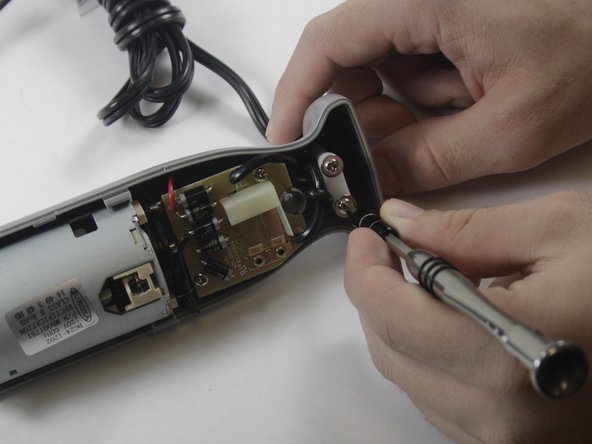

  4. Cuisinart Smart Stick CSB-75 Motor Replacement: crwdns2935265:04crwdnd2935265:01crwdnd2935265:03crwdne2935265:0 Cuisinart Smart Stick CSB-75 Motor Replacement: crwdns2935265:04crwdnd2935265:02crwdnd2935265:03crwdne2935265:0 Cuisinart Smart Stick CSB-75 Motor Replacement: crwdns2935265:04crwdnd2935265:03crwdnd2935265:03crwdne2935265:0
    • Unscrew the 4 screws on inside.
    • Remove 2 13.3mm Phillips PH#2 screws.
    • Remove 2 17.5 mm Phillips PH#2 screws.
    • Unscrewing these screws will isolate the motor.

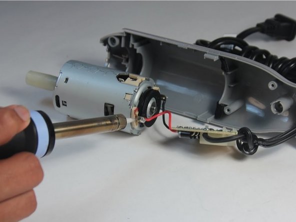

  5. Cuisinart Smart Stick CSB-75 Motor Replacement: crwdns2935265:05crwdnd2935265:01crwdnd2935265:03crwdne2935265:0 Cuisinart Smart Stick CSB-75 Motor Replacement: crwdns2935265:05crwdnd2935265:02crwdnd2935265:03crwdne2935265:0 Cuisinart Smart Stick CSB-75 Motor Replacement: crwdns2935265:05crwdnd2935265:03crwdnd2935265:03crwdne2935265:0
    • Refer to these steps on Soldering to replace the motor in the smart stick.
    • Be careful when soldering; it gets very hot.
