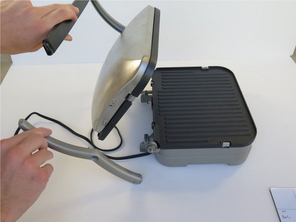

Cuisinart Griddler GR-4N Handle Replacement
  1. Cuisinart Griddler GR-4N Handle Replacement, Handle: crwdns2935265:01crwdnd2935265:01crwdnd2935265:01crwdne2935265:0
    • Ensure device is turned off, unplugged, cooled down and clean before attempting any replacements.
    • Start by unscrewing the triple-square bolt.
  2. Cuisinart Griddler GR-4N Handle Replacement: crwdns2935265:02crwdnd2935265:01crwdnd2935265:01crwdne2935265:0
    • Next, unscrew the Phillips #2 screw attaching it to the black handle .
  3. Cuisinart Griddler GR-4N Handle Replacement: crwdns2935265:03crwdnd2935265:01crwdnd2935265:02crwdne2935265:0 Cuisinart Griddler GR-4N Handle Replacement: crwdns2935265:03crwdnd2935265:02crwdnd2935265:02crwdne2935265:0
    • You can now pull the handle off of the griddler and reattach a working handle.

I need a replacement triple-square bolt - anyone know where I could find one? I emailed cuisinart
