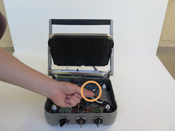

  5. Cuisinart Griddler GR- 4N LED Light  Replacement: crwdns2935265:05crwdnd2935265:01crwdnd2935265:02crwdne2935265:0 Cuisinart Griddler GR- 4N LED Light  Replacement: crwdns2935265:05crwdnd2935265:02crwdnd2935265:02crwdne2935265:0
    • Lift the bottom heating apparatus up and remove large black center piece by pushing down on black button while sliding out.
    • Realign all surface and put device back together making sure all parts are lined up and heating surfaces are making contact.
    • The aligned parts will allow the cooking surfaces to work properly.

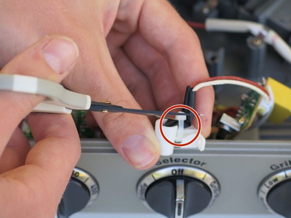

  8. Cuisinart Griddler GR- 4N LED Light  Replacement, LED Light: crwdns2935265:08crwdnd2935265:01crwdnd2935265:02crwdne2935265:0 Cuisinart Griddler GR- 4N LED Light  Replacement, LED Light: crwdns2935265:08crwdnd2935265:02crwdnd2935265:02crwdne2935265:0
    • Cut the zip ties which hold the LED lights in place with scissors/knife.
  9. Cuisinart Griddler GR- 4N LED Light  Replacement: crwdns2935265:09crwdnd2935265:01crwdnd2935265:02crwdne2935265:0 Cuisinart Griddler GR- 4N LED Light  Replacement: crwdns2935265:09crwdnd2935265:02crwdnd2935265:02crwdne2935265:0
    • Slide back black plastic covers and cut the two wires connected to the LED with a pair of scissors.
    • The LED bulb should now be free to remove. In order to replace bulb you must solder the new LED into the existing wires.
    • Upon soldering the LED will need to be zip tied back in place.
