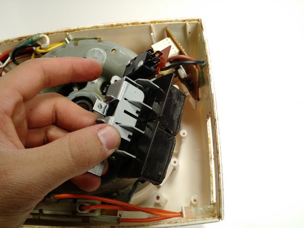

    • Pull out the three wires coming out of the power switch assembly by firmly grabbing the base of the wires and pulling.
  4. Cuisinart DLC-8F Power Switch Assembly Replacement: crwdns2935265:04crwdnd2935265:01crwdnd2935265:02crwdne2935265:0 Cuisinart DLC-8F Power Switch Assembly Replacement: crwdns2935265:04crwdnd2935265:02crwdnd2935265:02crwdne2935265:0
    • Remove the three 12 mm Phillips #2 screws from the power switch assembly.
  5. Cuisinart DLC-8F Power Switch Assembly Replacement: crwdns2935265:05crwdnd2935265:01crwdnd2935265:02crwdne2935265:0 Cuisinart DLC-8F Power Switch Assembly Replacement: crwdns2935265:05crwdnd2935265:02crwdnd2935265:02crwdne2935265:0
    • Pull out the power switch assembly with your hand.
    • This might take some jiggling and effort.
