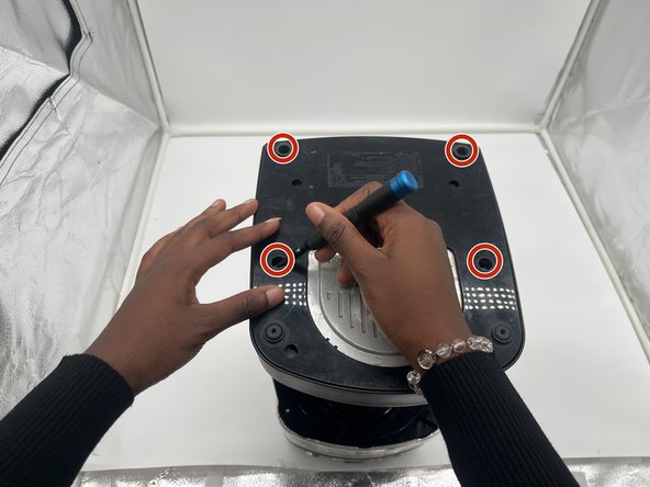

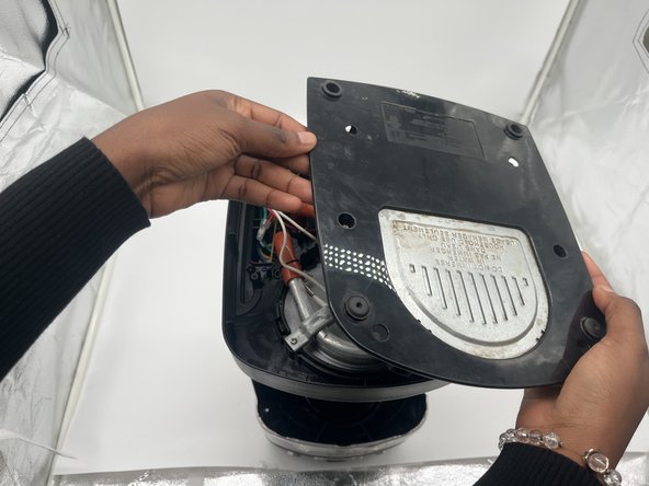

    • Turn the coffee maker upside down.
    • Remove the four 1.2 mm screws using a Phillips #0 screwdriver.
    • Remove the bottom cover to expose the heating element and motherboard.

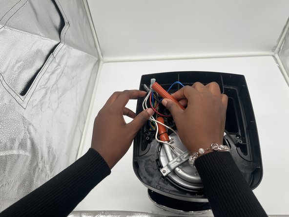

  2. Cuisinart DGB-650 Water Pipe Replacement: crwdns2935265:02crwdnd2935265:01crwdnd2935265:03crwdne2935265:0 Cuisinart DGB-650 Water Pipe Replacement: crwdns2935265:02crwdnd2935265:02crwdnd2935265:03crwdne2935265:0 Cuisinart DGB-650 Water Pipe Replacement: crwdns2935265:02crwdnd2935265:03crwdnd2935265:03crwdne2935265:0

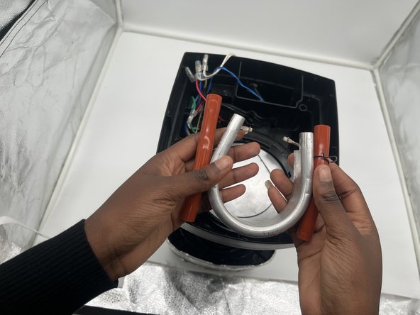

    • Firmly grasp both pipe endings next to the motherboard and gently pull both ends out.

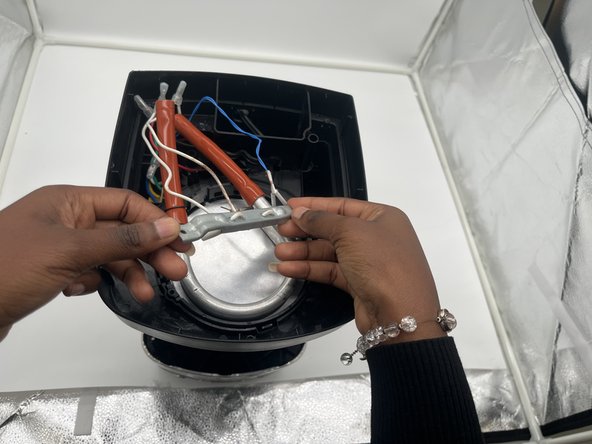

    • Remove the two 1.2 mm screws keeping the pipe clamp attached using a Phillips #0 screwdriver.
    • Lift the pipe clamp up and set it aside.

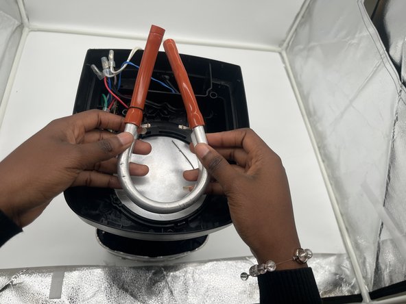

    • After heating the iOpener, wrap it around the ends of the orange tubes to help loosen the glued material.

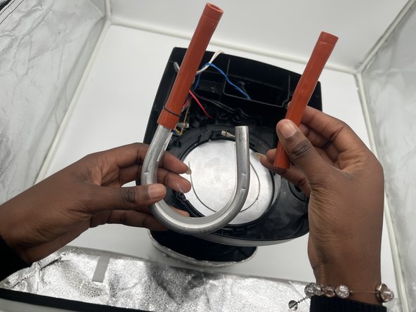

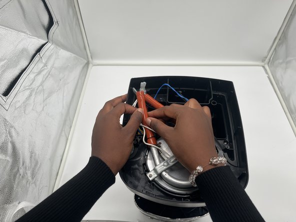

    • Wedge the metal spudger between the metal and the tube.
    • Shimmy the spudger around the entire tube until the tube is loosened and can be pulled off.
    • Repeat the process with the other orange tube still connected.
