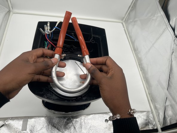

  2. Cuisinart DGB-650 Motherboard Replacement: crwdns2935265:02crwdnd2935265:01crwdnd2935265:03crwdne2935265:0 Cuisinart DGB-650 Motherboard Replacement: crwdns2935265:02crwdnd2935265:02crwdnd2935265:03crwdne2935265:0 Cuisinart DGB-650 Motherboard Replacement: crwdns2935265:02crwdnd2935265:03crwdnd2935265:03crwdne2935265:0
    • Firmly grasp both pipe endings next to the motherboard and gently pull both ends out.
  3. Cuisinart DGB-650 Motherboard Replacement: crwdns2935265:03crwdnd2935265:01crwdnd2935265:03crwdne2935265:0 Cuisinart DGB-650 Motherboard Replacement: crwdns2935265:03crwdnd2935265:02crwdnd2935265:03crwdne2935265:0 Cuisinart DGB-650 Motherboard Replacement: crwdns2935265:03crwdnd2935265:03crwdnd2935265:03crwdne2935265:0
    • Remove the two 1.2 mm screws keeping the pipe clamp attached using a Phillips #0 screwdriver.
    • Lift the pipe clamp up and set it aside.

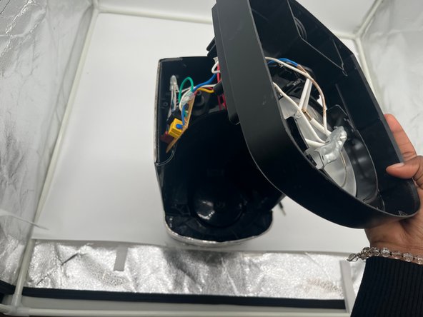

  4. Cuisinart DGB-650 Motherboard Replacement: crwdns2935265:04crwdnd2935265:01crwdnd2935265:03crwdne2935265:0 Cuisinart DGB-650 Motherboard Replacement: crwdns2935265:04crwdnd2935265:02crwdnd2935265:03crwdne2935265:0 Cuisinart DGB-650 Motherboard Replacement: crwdns2935265:04crwdnd2935265:03crwdnd2935265:03crwdne2935265:0
    • Remove the four 1.2 mm screws using a Phillips #0 screwdriver.
    • Remove the lid to get access to the motherboard.

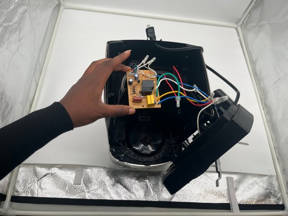

  5. Cuisinart DGB-650 Motherboard Replacement: crwdns2935265:05crwdnd2935265:01crwdnd2935265:02crwdne2935265:0 Cuisinart DGB-650 Motherboard Replacement: crwdns2935265:05crwdnd2935265:02crwdnd2935265:02crwdne2935265:0
    • Gently grasp and remove the expansion slot on the motherboard with the six colorful wires intertwined together.
    • Gently grasp and remove the expansion slot.

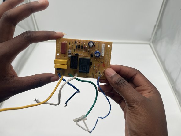

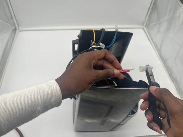

  6. Cuisinart DGB-650 Motherboard Replacement: crwdns2935265:06crwdnd2935265:01crwdnd2935265:03crwdne2935265:0 Cuisinart DGB-650 Motherboard Replacement: crwdns2935265:06crwdnd2935265:02crwdnd2935265:03crwdne2935265:0 Cuisinart DGB-650 Motherboard Replacement: crwdns2935265:06crwdnd2935265:03crwdnd2935265:03crwdne2935265:0
    • Use pliers to remove the plastic clamps from each of the six wires connected to the motherboard.
    • The motherboard should now be completely separated from the coffee maker.
