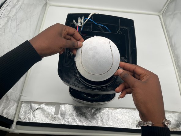

    • Turn the coffee maker upside down.
    • Remove the four 1.2 mm screws using a Phillips #0 screwdriver.
    • Remove the bottom cover to expose the heating element and pipes.
  2. Cuisinart DGB-650 Heating Element Replacement: crwdns2935265:02crwdnd2935265:01crwdnd2935265:03crwdne2935265:0 Cuisinart DGB-650 Heating Element Replacement: crwdns2935265:02crwdnd2935265:02crwdnd2935265:03crwdne2935265:0 Cuisinart DGB-650 Heating Element Replacement: crwdns2935265:02crwdnd2935265:03crwdnd2935265:03crwdne2935265:0
    • Firmly grasp both pipe endings next to the motherboard and gently pull both ends out.
  3. Cuisinart DGB-650 Heating Element Replacement: crwdns2935265:03crwdnd2935265:01crwdnd2935265:02crwdne2935265:0 Cuisinart DGB-650 Heating Element Replacement: crwdns2935265:03crwdnd2935265:02crwdnd2935265:02crwdne2935265:0
    • Remove the two 1.2 mm screws keeping the pipe clamp attached using a Phillips #0 screwdriver.
    • Lift the pipe clamp up and set it aside.
  4. Cuisinart DGB-650 Heating Element Replacement: crwdns2935265:04crwdnd2935265:01crwdnd2935265:02crwdne2935265:0 Cuisinart DGB-650 Heating Element Replacement: crwdns2935265:04crwdnd2935265:02crwdnd2935265:02crwdne2935265:0
    • Wedge the metal spudger between the heating element and the plastic.
    • Remove the heating element.
