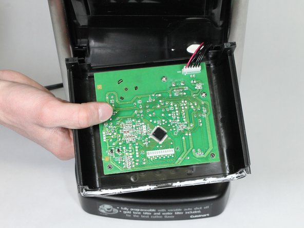

  4. Cuisinart DCC-1200 Toggle Switch Replacement: crwdns2935265:04crwdnd2935265:01crwdnd2935265:02crwdne2935265:0 Cuisinart DCC-1200 Toggle Switch Replacement: crwdns2935265:04crwdnd2935265:02crwdnd2935265:02crwdne2935265:0
    • Remove the electrical connection to the circuit board by carefully removing the connection by pulling straight up and away from the circuit board.
    • Once the electrical connection is removed, separate the face plate from the rest of the coffee maker.

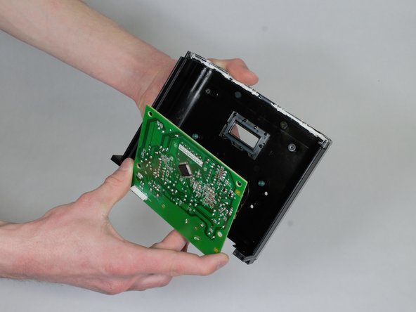

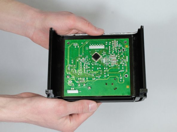

  5. Cuisinart DCC-1200 Toggle Switch Replacement: crwdns2935265:05crwdnd2935265:01crwdnd2935265:03crwdne2935265:0 Cuisinart DCC-1200 Toggle Switch Replacement: crwdns2935265:05crwdnd2935265:02crwdnd2935265:03crwdne2935265:0 Cuisinart DCC-1200 Toggle Switch Replacement: crwdns2935265:05crwdnd2935265:03crwdnd2935265:03crwdne2935265:0
    • Use the bit driver with the PH1 Philips bit to remove the three 11 mm long screws holding the circuit board to the face plate.
    • Once the circuit board screws are removed, carefully remove the circuit board from the face plate revealing the inside of the face plate.

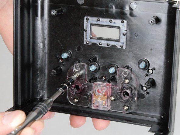

  6. Cuisinart DCC-1200 Toggle Switch Replacement: crwdns2935265:06crwdnd2935265:01crwdnd2935265:02crwdne2935265:0 Cuisinart DCC-1200 Toggle Switch Replacement: crwdns2935265:06crwdnd2935265:02crwdnd2935265:02crwdne2935265:0
    • Remove the four 10 mm long screws with the bit driver with the PH1 Phillips bit driver from the toggle switch plate.
    • Once the screws are removed, remove the toggle switch plate from the face plate.

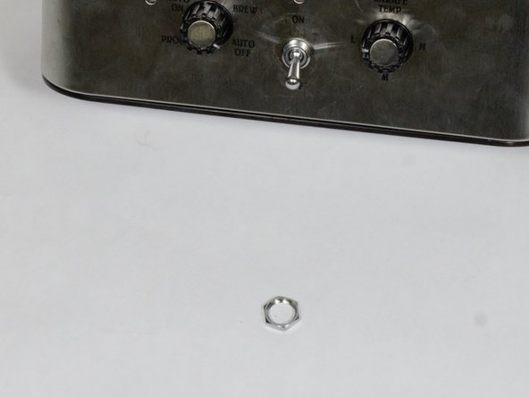

  7. Cuisinart DCC-1200 Toggle Switch Replacement: crwdns2935265:07crwdnd2935265:01crwdnd2935265:02crwdne2935265:0 Cuisinart DCC-1200 Toggle Switch Replacement: crwdns2935265:07crwdnd2935265:02crwdnd2935265:02crwdne2935265:0
    • Remove the hex nut from behind the toggle switch on the front of the face plate.

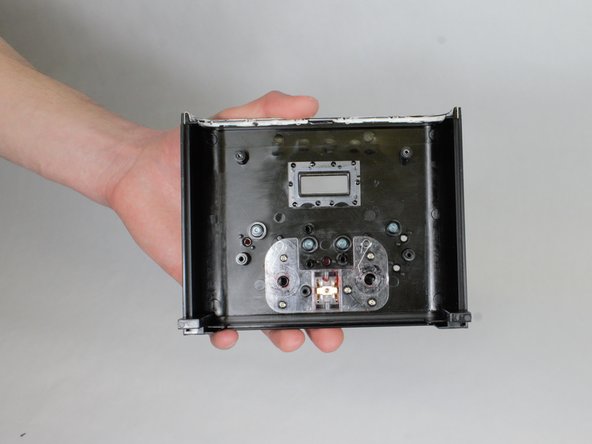

  8. Cuisinart DCC-1200 Toggle Switch Replacement: crwdns2935265:08crwdnd2935265:01crwdnd2935265:01crwdne2935265:0
    • Remove toggle switch by pulling it out from inside the face plate.
