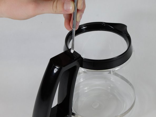

  4. Cuisinart DCC-1200 Coffee Carafe Handle Replacement: crwdns2935265:04crwdnd2935265:01crwdnd2935265:02crwdne2935265:0 Cuisinart DCC-1200 Coffee Carafe Handle Replacement: crwdns2935265:04crwdnd2935265:02crwdnd2935265:02crwdne2935265:0
    • Position the metal spudger underneath the top cap of the handle.
    • Gently pry up to extract the upper assembly cap.
    • Pry carefully to prevent from causing aesthetic damage to upper assembly cap.
  5. Cuisinart DCC-1200 Coffee Carafe Handle Replacement: crwdns2935265:05crwdnd2935265:01crwdnd2935265:01crwdne2935265:0
    • Use the bit driver with the Phillips PH1 to remove the 5 millimeter screw in upper assembly of handle.
    • Remove handle by lifting straight up.
