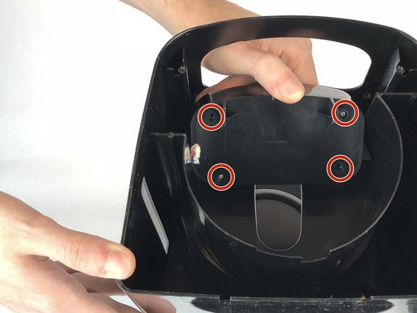

  5. Cuisinart DCC-1100 Selection Knob Replacement: crwdns2935265:05crwdnd2935265:01crwdnd2935265:02crwdne2935265:0 Cuisinart DCC-1100 Selection Knob Replacement: crwdns2935265:05crwdnd2935265:02crwdnd2935265:02crwdne2935265:0
    • Push the display into the maker so that way you can access the screws in the back.
    • Remove the four 1mm Phillips #0 screws from the back.
  6. Cuisinart DCC-1100 Selection Knob Replacement: crwdns2935265:06crwdnd2935265:01crwdnd2935265:02crwdne2935265:0 Cuisinart DCC-1100 Selection Knob Replacement: crwdns2935265:06crwdnd2935265:02crwdnd2935265:02crwdne2935265:0
    • Remove the back panel.
    • Remove the front panel from the display.
