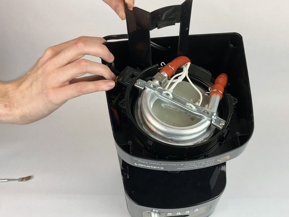

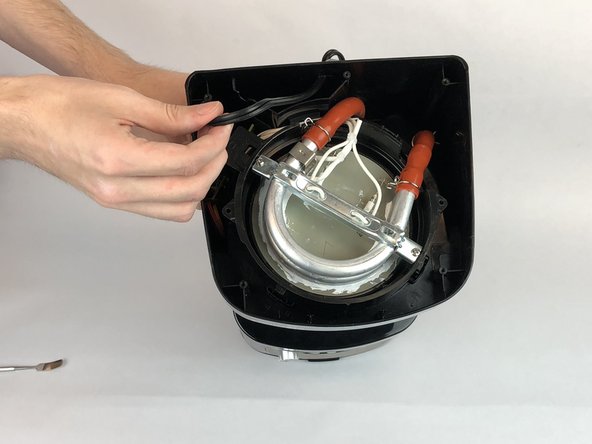

    • Push the power cord inward and away from the plastic protection plate.
  4. Cuisinart DCC-1100 Power Cord Replacement: crwdns2935265:04crwdnd2935265:01crwdnd2935265:02crwdne2935265:0 Cuisinart DCC-1100 Power Cord Replacement: crwdns2935265:04crwdnd2935265:02crwdnd2935265:02crwdne2935265:0
    • Remove the two 1.4mm Phillips #0 screws from the plastic protection plate.
    • Remove the plastic protection plate.

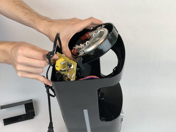

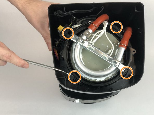

  5. Cuisinart DCC-1100 Power Cord Replacement: crwdns2935265:05crwdnd2935265:01crwdnd2935265:03crwdne2935265:0 Cuisinart DCC-1100 Power Cord Replacement: crwdns2935265:05crwdnd2935265:02crwdnd2935265:03crwdne2935265:0 Cuisinart DCC-1100 Power Cord Replacement: crwdns2935265:05crwdnd2935265:03crwdnd2935265:03crwdne2935265:0
    • Remove the two 1.6mm Phillips #1 screws from the heating element.
    • Using a flathead screwdriver to remove the outer clips holding the heating unit in place.
    • Flip the heating element up to allow access to the circuit board.

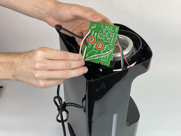

  6. Cuisinart DCC-1100 Power Cord Replacement: crwdns2935265:06crwdnd2935265:01crwdnd2935265:02crwdne2935265:0 Cuisinart DCC-1100 Power Cord Replacement: crwdns2935265:06crwdnd2935265:02crwdnd2935265:02crwdne2935265:0
    • Pull out the circuit board and rest it on the side of the machine.
    • Desolder the power cable from the motherboard.
