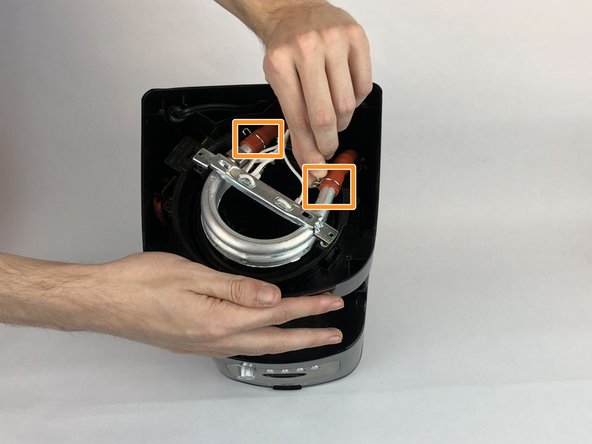

  4. Cuisinart DCC-1100 Heating Element Replacement: crwdns2935265:04crwdnd2935265:01crwdnd2935265:02crwdne2935265:0 Cuisinart DCC-1100 Heating Element Replacement: crwdns2935265:04crwdnd2935265:02crwdnd2935265:02crwdne2935265:0
    • Disconnect the heating element.
    • Pinch the tube clips and remove from tubes from the heating element.
