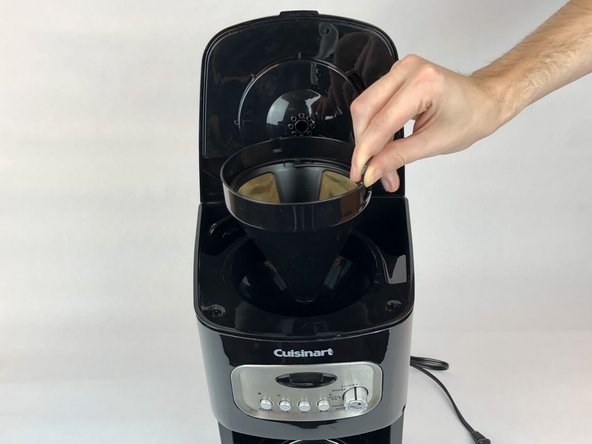

    • Unplug the coffee maker.
  2. Cuisinart DCC-1100 Drip Spring Replacement: crwdns2935265:02crwdnd2935265:01crwdnd2935265:01crwdne2935265:0
    • Remove the coffee pot and open the top lid.
  3. Cuisinart DCC-1100 Drip Spring Replacement: crwdns2935265:03crwdnd2935265:01crwdnd2935265:02crwdne2935265:0 Cuisinart DCC-1100 Drip Spring Replacement: crwdns2935265:03crwdnd2935265:02crwdnd2935265:02crwdne2935265:0
    • Remove the basket filter holder.
  4. Cuisinart DCC-1100 Drip Spring Replacement: crwdns2935265:04crwdnd2935265:01crwdnd2935265:01crwdne2935265:0
    • Remove the basket filter from the holder.
  5. Cuisinart DCC-1100 Drip Spring Replacement: crwdns2935265:05crwdnd2935265:01crwdnd2935265:01crwdne2935265:0
    • Press up on the drip spring mechanism.
  6. Cuisinart DCC-1100 Drip Spring Replacement: crwdns2935265:06crwdnd2935265:01crwdnd2935265:02crwdne2935265:0 Cuisinart DCC-1100 Drip Spring Replacement: crwdns2935265:06crwdnd2935265:02crwdnd2935265:02crwdne2935265:0
    • While pressing up on the drip spring mechanism, remove the clear round plastic retainer holding the mechanism in place.
  7. Cuisinart DCC-1100 Drip Spring Replacement: crwdns2935265:07crwdnd2935265:01crwdnd2935265:01crwdne2935265:0
    • Remove the spring from the dripper.

Where do you find replacement springs?
Mrich - crwdns2934203:0crwdne2934203:0
I have Cuisinart's Grind & Brew machine and it has an identical drip plug assembly. I measured carefully with a caliper and arrived at this spring size: 12 mm OD, 0.5 mm wire diameter, 30 mm free length. https://www.amazon.com/uxcell-0-5mmx12mm...
Chris Rockett -
My basket holder has thrown off the clear plastic retainer ring; is there a replacement part I can purchase?
Raymond Classen - crwdns2934203:0crwdne2934203:0
When the basket holder came apart - the clear plasted retainer ring came off of mine, also. Can you just purchase this piece?
