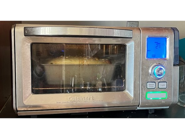

    • The problem:
    • The Add Water indicator shows, beeping every second, even though the external tank is full.

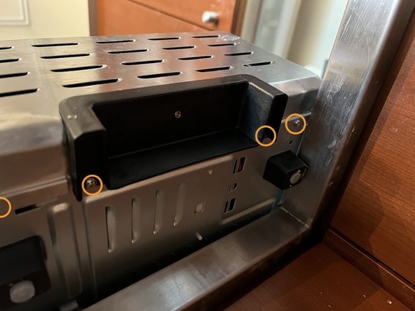

    • Disassembly: to get access to the underlying problem
    • • To get to the hose, I remove the right side cover.
    • • Start by removing the external tank,
    • • By the kitchen, unscrew the rear drain plug cap and tilt the Cuisinart slightly to let any water drain out into the sink.
    • (The black plastic drain cover is just a plastic on plastic join: be very careful not to cross-thread it, since you will be opening and closing it a few times in this repair.)
  4. Cuisinart Combo Steam Convection Oven CSO-300 repair steam function Replacement: crwdns2935265:04crwdnd2935265:01crwdnd2935265:02crwdne2935265:0 Cuisinart Combo Steam Convection Oven CSO-300 repair steam function Replacement: crwdns2935265:04crwdnd2935265:02crwdnd2935265:02crwdne2935265:0
    • • Remove the right side cover by unscrewing the four screws on the top of the cover (set safely aside) and
    • the four screws of the bottom cover (set safely aside) Note that the top screws are different than the bottom ones.
    • • Once the 8 screws are removed you can easily remove the right side cover. (the sheet metal edges can be sharp - be careful)

    • Confirmation of the fix.
    • • I let the toaster oven sit for a day, in case there was any residual internal water I missed, then used it as a toaster - at least that showed my work didn't make it worse.
    • • I filled the big transparent tank with water and put it on the toaster oven.
    • • I emptied the tank and put it back on the toaster oven. So now there was just what residual water remained.
    • • I set the toaster oven for "Bread", 400°, 30 minutes. I started it with no bread, just as a test. It started its regular cycle, producing the expected steam for the first 10 minutes, just running off the residual water.
    • • I let the toaster oven cool down, and ran it again. This time, I got the "Add water" indicator after a few minutes, so I just cancelled the rest of the run. This proves that enough water flows through the system to run the steam function, and the "Add water" detector still works.
