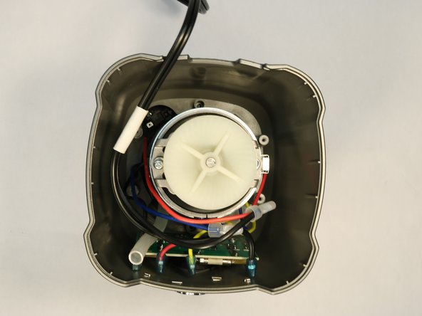

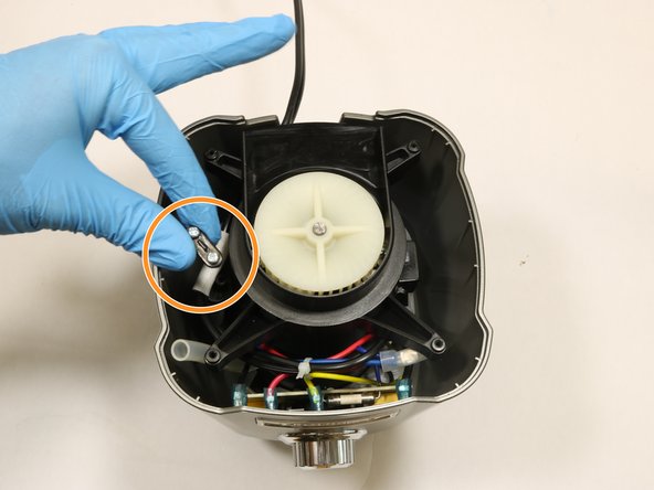

  3. Cuisinart CPB-380 Power Cord Replacement: crwdns2935265:03crwdnd2935265:01crwdnd2935265:03crwdne2935265:0 Cuisinart CPB-380 Power Cord Replacement: crwdns2935265:03crwdnd2935265:02crwdnd2935265:03crwdne2935265:0 Cuisinart CPB-380 Power Cord Replacement: crwdns2935265:03crwdnd2935265:03crwdnd2935265:03crwdne2935265:0
    • Remove the two 11mm screws securing the power cord using the Phillips #2 screwdriver.
    • Gently move the wire aside so that it is not in the way.

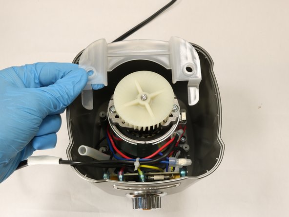

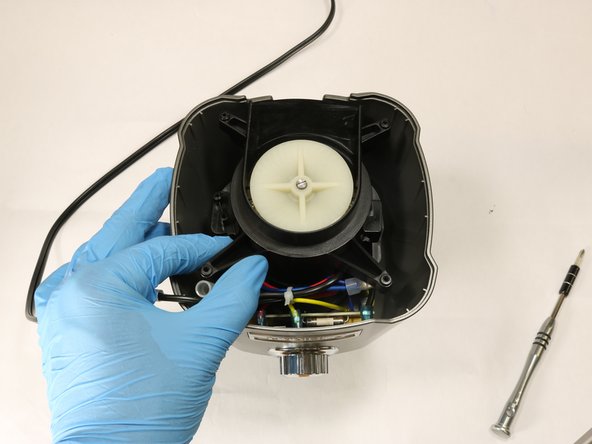

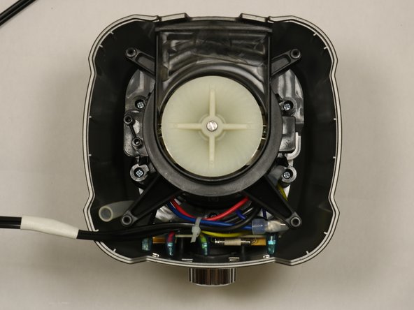

  4. Cuisinart CPB-380 Power Cord Replacement: crwdns2935265:04crwdnd2935265:01crwdnd2935265:03crwdne2935265:0 Cuisinart CPB-380 Power Cord Replacement: crwdns2935265:04crwdnd2935265:02crwdnd2935265:03crwdne2935265:0 Cuisinart CPB-380 Power Cord Replacement: crwdns2935265:04crwdnd2935265:03crwdnd2935265:03crwdne2935265:0
    • Remove the four 13mm screws that hold the black plastic cover using the Phillips #2 screwdriver.
    • Gently remove the black cover.
    • Underneath, you will see a clear plastic cover that should be removed as well.

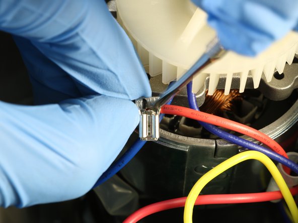

  6. Cuisinart CPB-380 Power Cord Replacement, Power Cord: crwdns2935265:06crwdnd2935265:01crwdnd2935265:02crwdne2935265:0 Cuisinart CPB-380 Power Cord Replacement, Power Cord: crwdns2935265:06crwdnd2935265:02crwdnd2935265:02crwdne2935265:0
    • Remove the 2 black, yellow, and red wires from circuit board by push down on the tab to release and then pull up.
  7. Cuisinart CPB-380 Power Cord Replacement: crwdns2935265:07crwdnd2935265:01crwdnd2935265:01crwdne2935265:0
    • Pinch perpendicular to the flat surface and pull out the black wire.
