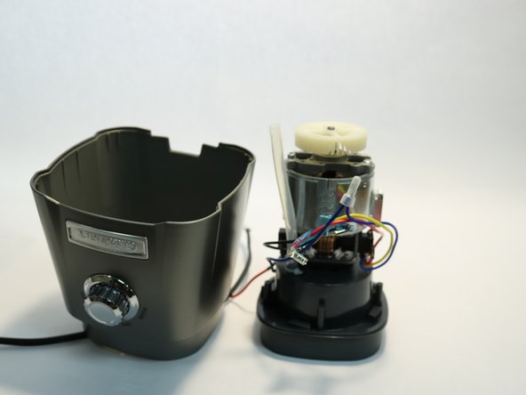

    • Turn the device upside down.
    • Remove all four rubber feet by prying them out using the metal spudger.
    • Once the rubber feet have been removed, use the Phillips #2 screwdriver to remove all four 13mm screws.
  2. Cuisinart CPB-380 Motor Replacement: crwdns2935265:02crwdnd2935265:01crwdnd2935265:02crwdne2935265:0 Cuisinart CPB-380 Motor Replacement: crwdns2935265:02crwdnd2935265:02crwdnd2935265:02crwdne2935265:0
    • Remove the base from the body of the blender.

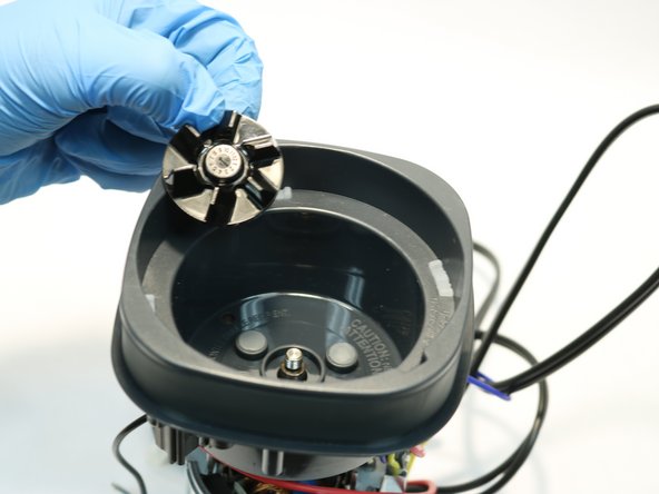

    • Grab the motor by the black gear and the white filter.
    • Unscrew the black gear.

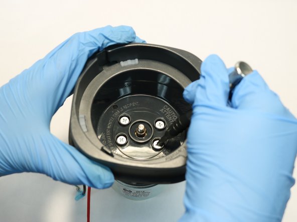

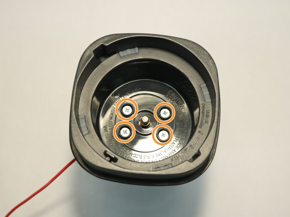

  8. Cuisinart CPB-380 Motor Replacement: crwdns2935265:08crwdnd2935265:01crwdnd2935265:03crwdne2935265:0 Cuisinart CPB-380 Motor Replacement: crwdns2935265:08crwdnd2935265:02crwdnd2935265:03crwdne2935265:0 Cuisinart CPB-380 Motor Replacement: crwdns2935265:08crwdnd2935265:03crwdnd2935265:03crwdne2935265:0
    • With the metal spudger remove the four rubber stoppers.
    • Remove the four 13mm screws with the Phillips #2 screwdriver.
  9. Cuisinart CPB-380 Motor Replacement: crwdns2935265:09crwdnd2935265:01crwdnd2935265:01crwdne2935265:0
    • Separate the top from the motor.
    • Pinch perpendicular to the flat surface and pull out the blue wire.
