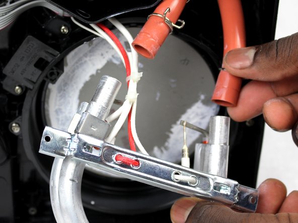

    • Remove the two 10mm screws with a Phillips head screwdriver.
    • Position the heating coil connected to the hose for easier access to the clamps.
    • Beware of grey silicone. This paste is nontoxic to the touch but is poisonous if consumed.
  4. Cuisinart CHW-12 Water Hoses Replacement: crwdns2935265:04crwdnd2935265:01crwdnd2935265:02crwdne2935265:0 Cuisinart CHW-12 Water Hoses Replacement: crwdns2935265:04crwdnd2935265:02crwdnd2935265:02crwdne2935265:0

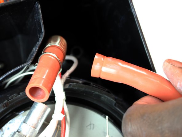

    • Squeeze the two hose clamps together as you slide the clamps away from the heating element.
    • After the clamped are cleared of the heating element, gently remove the hoses from the coil.

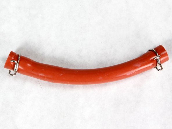

    • Squeeze the clamp on the opposite end of the hose(s) that need replacement.
    • Once the clamp is free on the opposing end, gently pull the hose upwards to remove it.
    • Replace the disconnected hose with a new functional hose.

Um, you forgot a MAJOR detail; there is a ball valve backflow preventer in the existing hose, which MUST be transferred into the replacement hose.
If it is not replaced, the coffe machine will NOT WORK. - You are welcome.

Also, the measurements for the hose ID and OD are incorrect. The ID is at least 10 mm. I tried using the measurements you gave, which translate to 8mm ID x 12 mm OD, and that is way too small. The check valve will NOT fit into this smaller diameter tubing. The check valve body itself is 10mm in diameter. I ordered some of the size you listed and it is easily seen without measuring that the tubing doesn't come close to matching.
