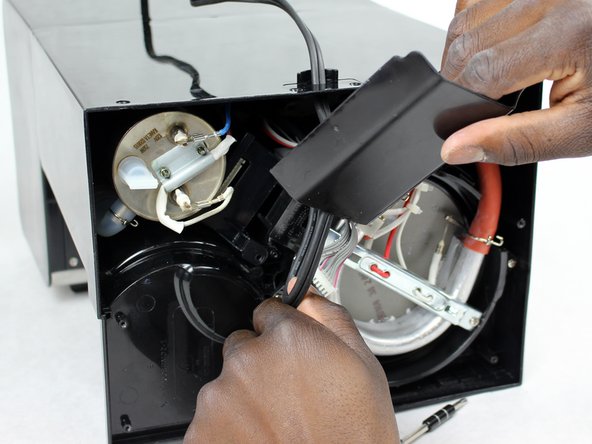

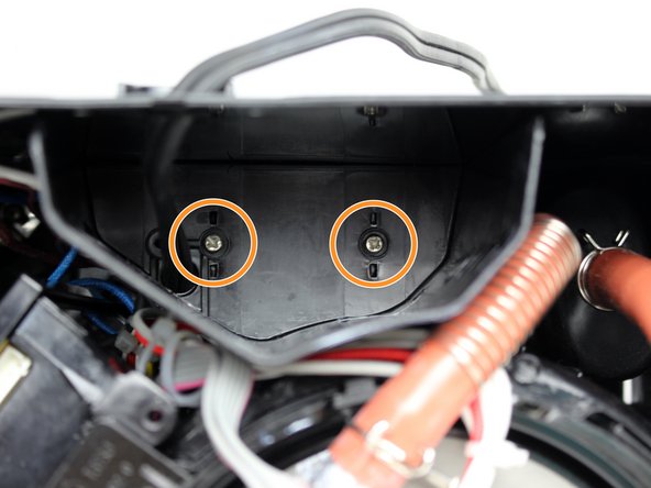

  4. Cuisinart CHW-12 Power Cord Replacement: crwdns2935265:04crwdnd2935265:01crwdnd2935265:03crwdne2935265:0 Cuisinart CHW-12 Power Cord Replacement: crwdns2935265:04crwdnd2935265:02crwdnd2935265:03crwdne2935265:0 Cuisinart CHW-12 Power Cord Replacement: crwdns2935265:04crwdnd2935265:03crwdnd2935265:03crwdne2935265:0
    • Locate the Phillips head screws holding the highlighted plastic shield in place.
    • Remove the two 14mm screws with a Phillips head screwdriver.
    • Carefully slide the shield out of place along the power cord and set it aside.

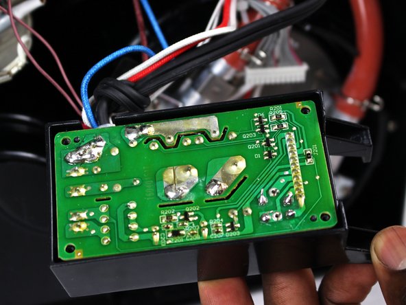

  5. Cuisinart CHW-12 Power Cord Replacement: crwdns2935265:05crwdnd2935265:01crwdnd2935265:03crwdne2935265:0 Cuisinart CHW-12 Power Cord Replacement: crwdns2935265:05crwdnd2935265:02crwdnd2935265:03crwdne2935265:0 Cuisinart CHW-12 Power Cord Replacement: crwdns2935265:05crwdnd2935265:03crwdnd2935265:03crwdne2935265:0
    • Remove the two 14mm Phillips head screws securing the plastic containment box.
    • Pull the plastic containment box straight out of the coffee maker.

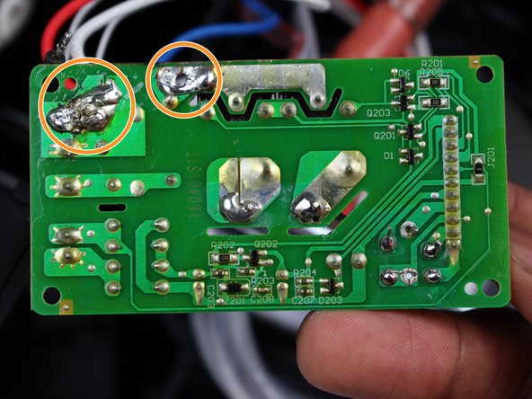

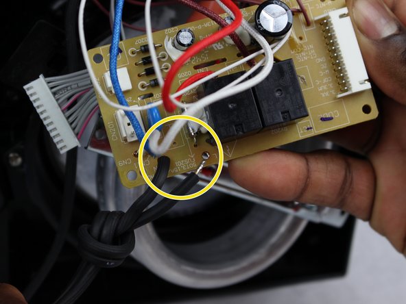

  7. Cuisinart CHW-12 Power Cord Replacement: crwdns2935265:07crwdnd2935265:01crwdnd2935265:03crwdne2935265:0 Cuisinart CHW-12 Power Cord Replacement: crwdns2935265:07crwdnd2935265:02crwdnd2935265:03crwdne2935265:0 Cuisinart CHW-12 Power Cord Replacement: crwdns2935265:07crwdnd2935265:03crwdnd2935265:03crwdne2935265:0
    • Pull the circuit board out of the containment box.
    • Locate the power cable connection point on the circuit board.
    • Desolder the power cable wires connected to the board.
    • Solder iron can cause burns if used improperly.
    • Replace the power cable with the corresponding wires of the new power cable.
