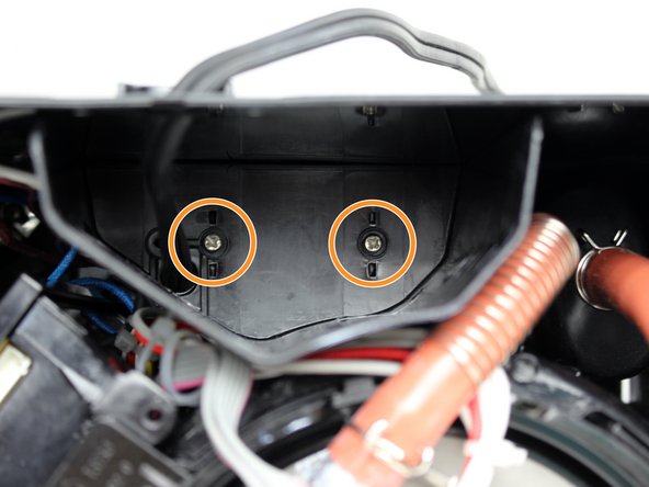

    • Locate the Phillips head screws holding the highlighted plastic shield in place.
    • Remove the two 14mm screws with a Phillips head screwdriver.
    • Carefully slide the shield out of place along the power cord and set it aside.

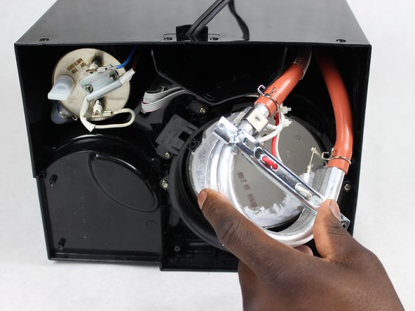

    • Remove the two 14mm Phillips head screws that hold the heating coil in place.
  8. Cuisinart CHW-12 Heating Coil Replacement: crwdns2935265:08crwdnd2935265:01crwdnd2935265:03crwdne2935265:0 Cuisinart CHW-12 Heating Coil Replacement: crwdns2935265:08crwdnd2935265:02crwdnd2935265:03crwdne2935265:0 Cuisinart CHW-12 Heating Coil Replacement: crwdns2935265:08crwdnd2935265:03crwdnd2935265:03crwdne2935265:0
    • Pull back each hose clamp so that it no longer holds the hose on the heating coil.
    • After the clamps are released pull both hoses off the ends of the heating coil.
    • Set the coil aside.

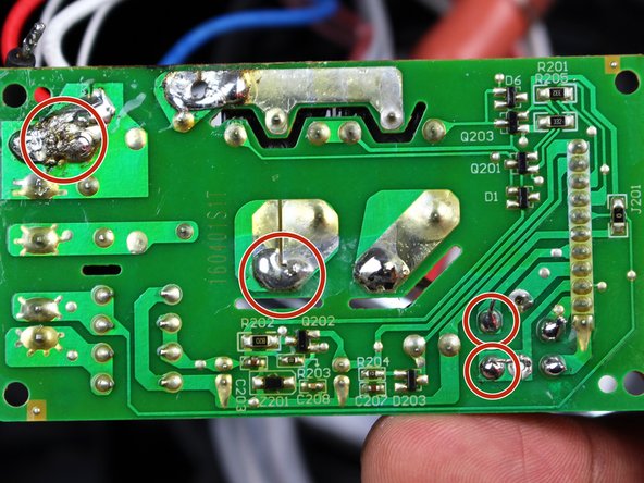

    • De-solder each of the four wires connecting the coil to the circuit board.
    • Solder iron can cause burns if used improperly.
    • When soldering the new wires in place make sure they are placed in the same holes the corresponding wires were taken out of.
