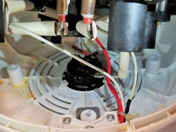

    • Lift dipping pan from the plastic casing.
    • Dipping pan connects to plastic casing with nondetachable wiring.
    • The two wires connected to the black connector transfer the AC power from the base to the heating coil underneath the pan surface.
    • White sleeves surround the wires, protecting them from heat damage.
    • The black connector also holds a grounding strip not connected to a wire.

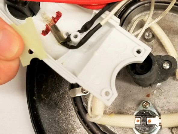

    • Unscrew 3 #1-20x10mm screws connecting the top of the handle to reveal the inside of the handle, switch wiring, and yellow tab covering the LED.
    • When the switch is open, the flow of electricity is interrupted and no heating occurs

    • Unscrew #1-20x6mm screw on black temperature sensor to reveal a gooey substance between sensor and the metal undercoating of the heating surface
    • While the coil heats and the heating surface is below optimal cooking temperature, power enters the coil and turns on the LED.
    • Upon reaching the optimal temperature, the power to the coil shuts off and the LED turns off, indicating the crepe is done.
