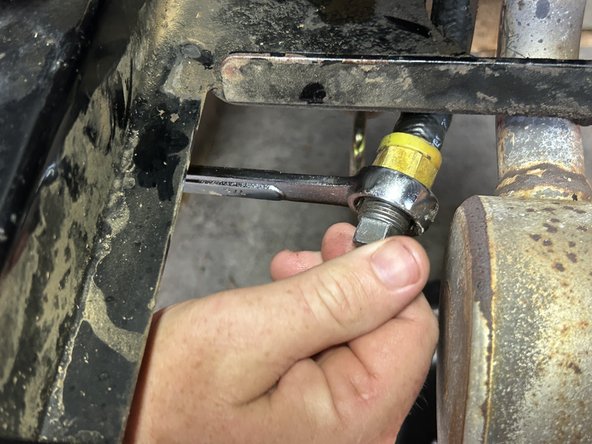

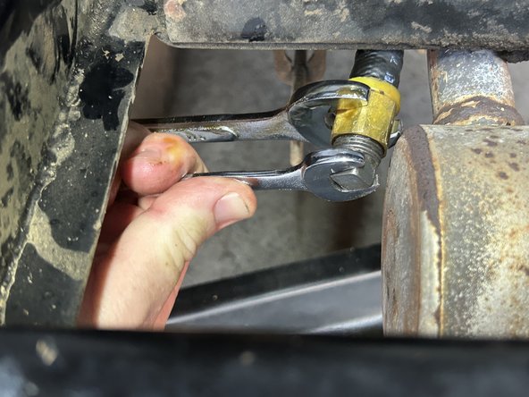

    • Hold the tip of the oil drain hose with the closed end of a 3/4-inch combination wrench.
    • Use the open end of the 1/2 inch combination wrench to loosen the oil drain plug.
    • Finish loosening the drain plug with your hands and remove it.

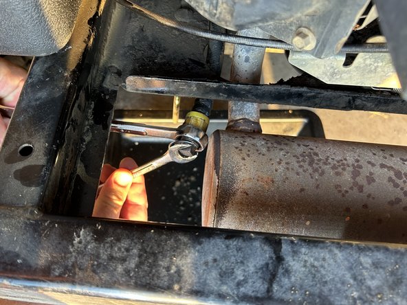

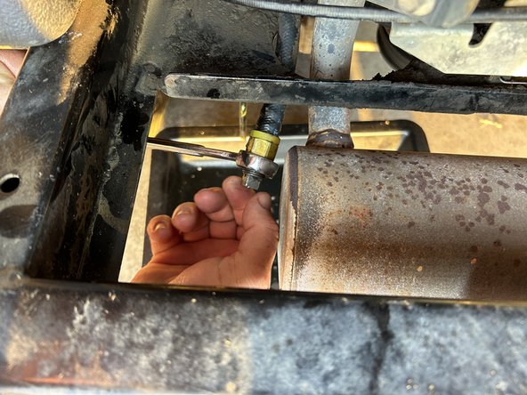

    • Reinsert the drain plug and tighten it with the open end of a 1/2-inch combination wrench.
    • Use a torque wrench to tighten 13.6 N·m (10 ft. lb.).
    • Refer to your owner's manual to ensure the correct tightness of the drain plug.

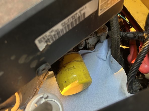

  5. Cub Cadet Z-Force 48 Oil Change: crwdns2935265:05crwdnd2935265:01crwdnd2935265:03crwdne2935265:0 Cub Cadet Z-Force 48 Oil Change: crwdns2935265:05crwdnd2935265:02crwdnd2935265:03crwdne2935265:0 Cub Cadet Z-Force 48 Oil Change: crwdns2935265:05crwdnd2935265:03crwdnd2935265:03crwdne2935265:0

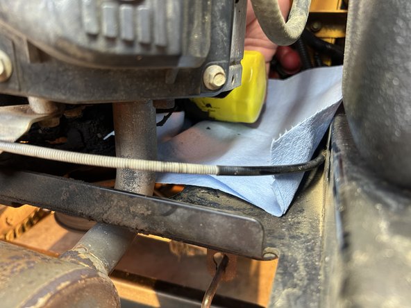

    • Place paper towels or an old rag under the old oil filter to catch any excess oil.
    • Remove the old oil filter.
    • If the oil filter is too tight, use oil filter pliers to loosen before removal.
  6. Cub Cadet Z-Force 48 Oil Change: crwdns2935265:06crwdnd2935265:01crwdnd2935265:01crwdne2935265:0
    • Replace the soiled paper towels underneath the oil filter mount.
    • Wipe the oil filter mount clean with paper towels.

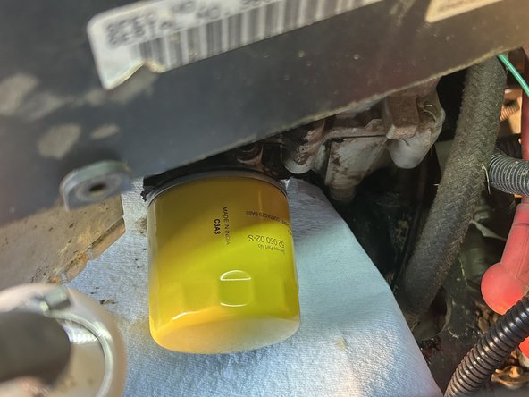

  7. Cub Cadet Z-Force 48 Oil Change: crwdns2935265:07crwdnd2935265:01crwdnd2935265:01crwdne2935265:0
    • Use your finger to place a thin film of clean oil on the O-ring of the new oil filter.
  8. Cub Cadet Z-Force 48 Oil Change: crwdns2935265:08crwdnd2935265:01crwdnd2935265:02crwdne2935265:0 Cub Cadet Z-Force 48 Oil Change: crwdns2935265:08crwdnd2935265:02crwdnd2935265:02crwdne2935265:0
    • Install the new oil filter, hand tightening the filter clockwise.
    • Tighten the oil filter until the rubber gasket contacts the oil filter mount, then tighten an additional 3/4-1 turn.
    • Refer to your owner's manual to ensure the correct tightness of the oil filter.

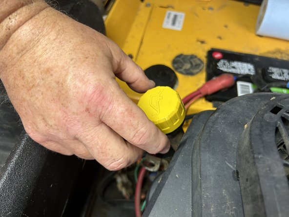

  9. Cub Cadet Z-Force 48 Oil Change: crwdns2935265:09crwdnd2935265:01crwdnd2935265:03crwdne2935265:0 Cub Cadet Z-Force 48 Oil Change: crwdns2935265:09crwdnd2935265:02crwdnd2935265:03crwdne2935265:0 Cub Cadet Z-Force 48 Oil Change: crwdns2935265:09crwdnd2935265:03crwdnd2935265:03crwdne2935265:0

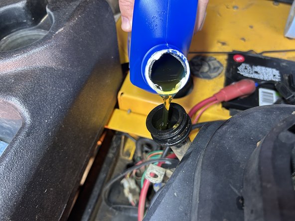

    • Remove the oil fill cap.
    • Fill the engine with the amount and type of oil specified in your owner's manual.
    • Put the oil fill cap back into place.
    • For this mower, any service class SG, SH, SJ, or higher oil can be used.
