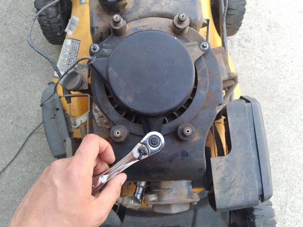

    • Using a wrench, remove the three nuts from the lawnmower’s defective recoil starter.
  4. Cub Cadet OHV 173cc/6.75 Recoil Starter Replacement: crwdns2935265:04crwdnd2935265:01crwdnd2935265:03crwdne2935265:0 Cub Cadet OHV 173cc/6.75 Recoil Starter Replacement: crwdns2935265:04crwdnd2935265:02crwdnd2935265:03crwdne2935265:0 Cub Cadet OHV 173cc/6.75 Recoil Starter Replacement: crwdns2935265:04crwdnd2935265:03crwdnd2935265:03crwdne2935265:0

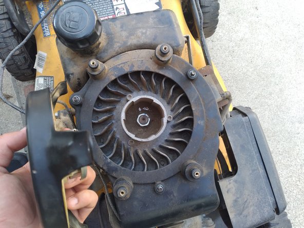

    • Remove the defective recoil starter by pulling up.
  5. Cub Cadet OHV 173cc/6.75 Recoil Starter Replacement: crwdns2935265:05crwdnd2935265:01crwdnd2935265:03crwdne2935265:0 Cub Cadet OHV 173cc/6.75 Recoil Starter Replacement: crwdns2935265:05crwdnd2935265:02crwdnd2935265:03crwdne2935265:0 Cub Cadet OHV 173cc/6.75 Recoil Starter Replacement: crwdns2935265:05crwdnd2935265:03crwdnd2935265:03crwdne2935265:0
