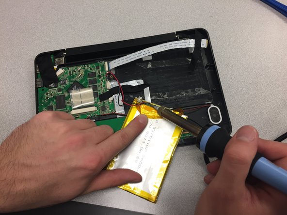

  5. CrystalView NB4-35788 Battery Replacement: crwdns2935265:05crwdnd2935265:01crwdnd2935265:02crwdne2935265:0 CrystalView NB4-35788 Battery Replacement: crwdns2935265:05crwdnd2935265:02crwdnd2935265:02crwdne2935265:0
    • Peel back the yellow film on the old battery to expose the red and black wires
    • De-solder these wires to disconnect the old battery
    • Be careful while using a soldering iron as it is extremely hot.
    • Follow the How To Solder and Desolder Connections guide for help.
