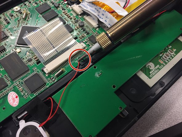

  6. CrystalView NB4-35788 Auxiliary Speakers Replacement: crwdns2935265:06crwdnd2935265:01crwdnd2935265:02crwdne2935265:0 CrystalView NB4-35788 Auxiliary Speakers Replacement: crwdns2935265:06crwdnd2935265:02crwdnd2935265:02crwdne2935265:0
    • De-solder the red and black wires to disconnect the old speaker.
    • Be careful while using a soldering iron as it is extremely hot.
    • Follow the How To Solder and Desolder Connections guide for help.
