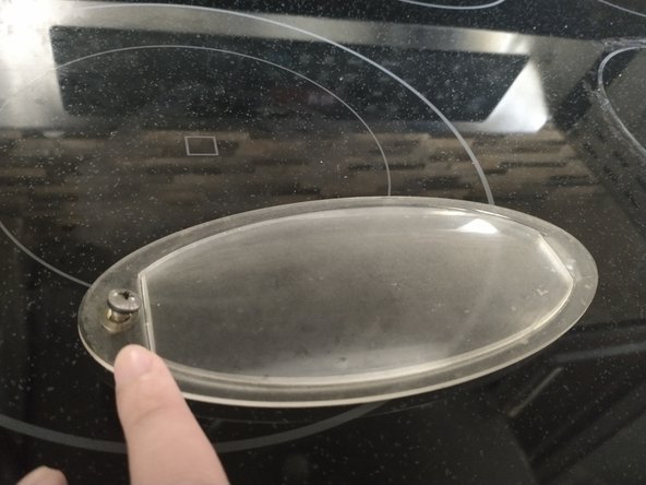

    • Use the Phillips #00 to remove the single screw securing the lightbulb panel to the ceiling of the range.
    • Too prevent both of the items from falling, hold onto the screw and panel during removal.
  3. Crown Range Hood AFG-AC/SS Light Bulb Replacement: crwdns2935265:03crwdnd2935265:01crwdnd2935265:01crwdne2935265:0
    • Slide the lightbulb cover out from the recessed area under the hood.
  4. Crown Range Hood AFG-AC/SS Light Bulb Replacement: crwdns2935265:04crwdnd2935265:01crwdnd2935265:02crwdne2935265:0 Crown Range Hood AFG-AC/SS Light Bulb Replacement: crwdns2935265:04crwdnd2935265:02crwdnd2935265:02crwdne2935265:0

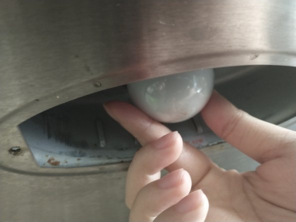

    • Twist the light bulb left to remove it from the range hood.
  5. Crown Range Hood AFG-AC/SS Light Bulb Replacement: crwdns2935265:05crwdnd2935265:01crwdnd2935265:01crwdne2935265:0
    • Use a cloth or a paper towel to clean the inside of the light bulb area.
    • Be sure to remove any debris or rust that might impair the installation of the new light bulb.
  6. Crown Range Hood AFG-AC/SS Light Bulb Replacement: crwdns2935265:06crwdnd2935265:01crwdnd2935265:01crwdne2935265:0
    • Guide the new lightbulb to the middle of the lightbulb base.
    • Install the new lightbulb with a twisting motion to the right.
    • Ensure the lightbulb is tightly secured onto the lightbulb base but don't overtighten.
