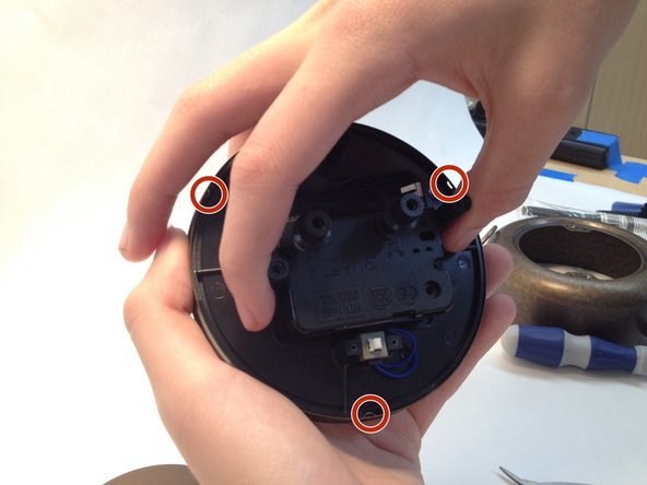

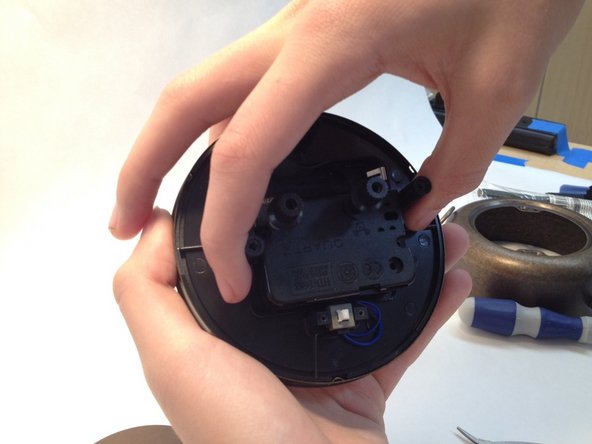

    • Rotate Clock till the face/or front is pointing away from you.
    • Continue on by unscrewing the 5.5 millimeter screws with your hands.
    • Once all the screws are removed, take the circular back panel off and lay it down flat on a stable surface to put back on later.

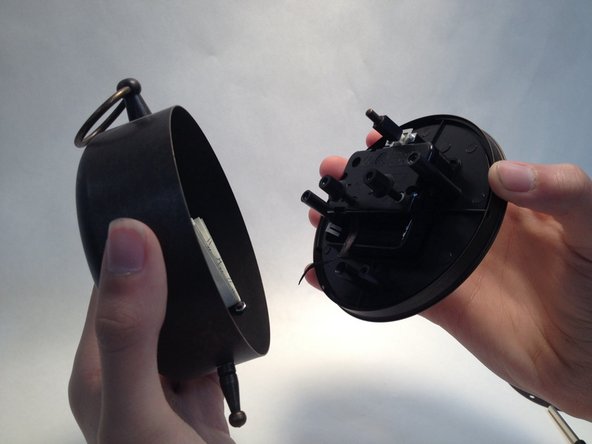

  2. Crosley 33301 Front Glass Replacement: crwdns2935265:02crwdnd2935265:01crwdnd2935265:02crwdne2935265:0 Crosley 33301 Front Glass Replacement: crwdns2935265:02crwdnd2935265:02crwdnd2935265:02crwdne2935265:0
    • Unscrew the two remaining screws with a PH2 bit.
    • Do not be afraid to use additional force to remove these screws. Just be careful not to break the clock!
  3. Crosley 33301 Front Glass Replacement: crwdns2935265:03crwdnd2935265:01crwdnd2935265:02crwdne2935265:0 Crosley 33301 Front Glass Replacement: crwdns2935265:03crwdnd2935265:02crwdnd2935265:02crwdne2935265:0
    • Remove the front part of the clock from the back frame.
    • No major force is required. The back frame should slide right off.

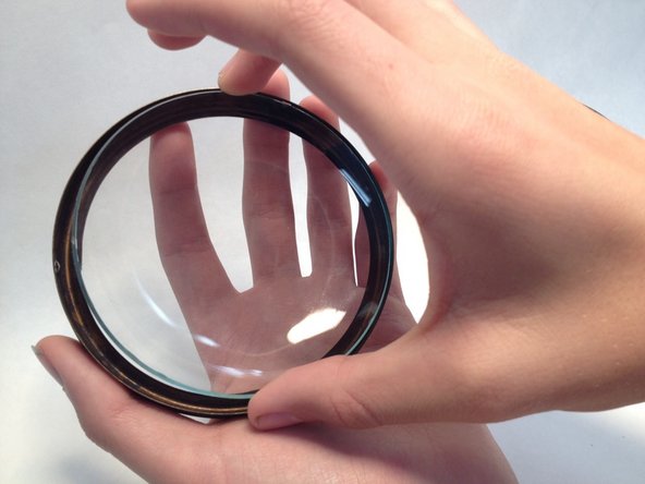

  4. Crosley 33301 Front Glass Replacement: crwdns2935265:04crwdnd2935265:01crwdnd2935265:02crwdne2935265:0 Crosley 33301 Front Glass Replacement: crwdns2935265:04crwdnd2935265:02crwdnd2935265:02crwdne2935265:0
    • You will notice that there are three small indents on alternate sides.
    • You will see small slits where the indents can slide through.
    • Twist the center counter clockwise so that the face and the back are no longer connected.
  5. Crosley 33301 Front Glass Replacement: crwdns2935265:05crwdnd2935265:01crwdnd2935265:02crwdne2935265:0 Crosley 33301 Front Glass Replacement: crwdns2935265:05crwdnd2935265:02crwdnd2935265:02crwdne2935265:0
    • Replace the front of the clock with your new glass face protector and settle it on the frame.
    • The glass for this clock is 10cm in diameter. It would be best to use glass that fits this measurement!
  6. Crosley 33301 Front Glass Replacement: crwdns2935265:06crwdnd2935265:01crwdnd2935265:03crwdne2935265:0 Crosley 33301 Front Glass Replacement: crwdns2935265:06crwdnd2935265:02crwdnd2935265:03crwdne2935265:0 Crosley 33301 Front Glass Replacement: crwdns2935265:06crwdnd2935265:03crwdnd2935265:03crwdne2935265:0
    • Apply the clock face back on the frame, then reverse your steps. Take a step back and admire your handiwork!
