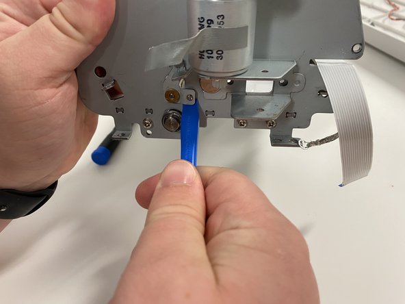

  16. Cricut Explore Air 2 Roller Bar Replacement, Roller Bar: crwdns2935265:016crwdnd2935265:01crwdnd2935265:01crwdne2935265:0
    • Locate the spring on the left side of the Cricut's metal interior frame.
    • Gently remove the spring by disconnecting the hooks on either side.
    • Repeat on the right side.
  17. Cricut Explore Air 2 Roller Bar Replacement: crwdns2935265:017crwdnd2935265:01crwdnd2935265:02crwdne2935265:0 Cricut Explore Air 2 Roller Bar Replacement: crwdns2935265:017crwdnd2935265:02crwdnd2935265:02crwdne2935265:0
    • Identify the metal piece holding the roller bar in place.
    • Wedge a prying tool underneath the metal to free the interior from this piece of the frame.
  18. Cricut Explore Air 2 Roller Bar Replacement: crwdns2935265:018crwdnd2935265:01crwdnd2935265:01crwdne2935265:0
    • Gently push the metal frame, skewing it to free the roller bar.
    • Do not push too hard or too quick, as you risk breaking the frame.
    • Repeat on the right side to fully free the roller bar.
