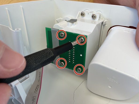

  4. Cricut Explore Air 2 Roller Bar Motor Replacement: crwdns2935265:04crwdnd2935265:01crwdnd2935265:02crwdne2935265:0 Cricut Explore Air 2 Roller Bar Motor Replacement: crwdns2935265:04crwdnd2935265:02crwdnd2935265:02crwdne2935265:0
    • Locate the circuit board on the cover just removed.
    • Use the Phillips #1 screwdriver to unscrew each of the four 10 mm screws.
  5. Cricut Explore Air 2 Roller Bar Motor Replacement: crwdns2935265:05crwdnd2935265:01crwdnd2935265:01crwdne2935265:0
    • Gently unplug the connector, removing the circuit board.
