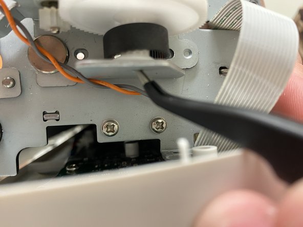

  16. Cricut Explore Air 2 Belt Replacement, Belt: crwdns2935265:016crwdnd2935265:01crwdnd2935265:02crwdne2935265:0 Cricut Explore Air 2 Belt Replacement, Belt: crwdns2935265:016crwdnd2935265:02crwdnd2935265:02crwdne2935265:0
    • On the left side of the Cricut, locate the c-clip attached on the bottom of the belt's housing.
    • Using tweezers, remove the c-clip.
  17. Cricut Explore Air 2 Belt Replacement: crwdns2935265:017crwdnd2935265:01crwdnd2935265:01crwdne2935265:0
    • Pull out the pin that was secured by the c-clip, which runs vertically through the belt's housing.
    • Repeat on the right side of the Cricut.
  18. Cricut Explore Air 2 Belt Replacement: crwdns2935265:018crwdnd2935265:01crwdnd2935265:02crwdne2935265:0 Cricut Explore Air 2 Belt Replacement: crwdns2935265:018crwdnd2935265:02crwdnd2935265:02crwdne2935265:0
    • On the left side of the Cricut, gently pull the plastic gear to remove the belt's housing.
    • Do not pull quickly or the belt will tear.
    • Repeat on the right side to fully free the belt.

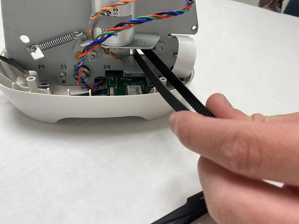

  19. Cricut Explore Air 2 Belt Replacement: crwdns2935265:019crwdnd2935265:01crwdnd2935265:01crwdne2935265:0
    • From the center of the Cricut, gently pull the belt to remove it from the machine.
