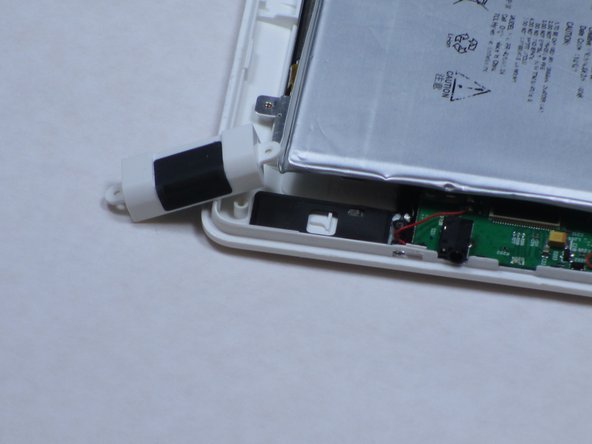

    • Remove the back panel by using the plastic opening tool to carefully pry around the panel's edges.
    • The volume control button and the top power button may fall out during this step.
  2. Creative Ziio 7" Right Speaker Replacement, Right Speaker: crwdns2935265:02crwdnd2935265:01crwdnd2935265:01crwdne2935265:0
    • The right speaker is directly below the battery as shown.
    • Remove the two 4mm Phillips #00 screws found in the speaker at the bottom left corner of the device.
  3. Creative Ziio 7" Right Speaker Replacement: crwdns2935265:03crwdnd2935265:01crwdnd2935265:02crwdne2935265:0 Creative Ziio 7" Right Speaker Replacement: crwdns2935265:03crwdnd2935265:02crwdnd2935265:02crwdne2935265:0
    • Once the screws are removed, discard the broken speaker.
    • Replace the broken speaker with a new right speaker.
