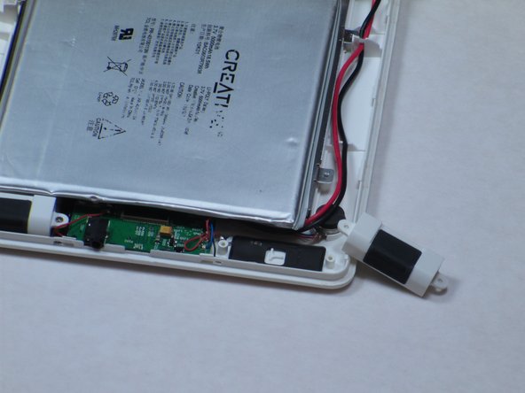

    1. Creative Ziio 7" Left Speaker Replacement, Back Panel: crwdns2935265:01crwdnd2935265:01crwdnd2935265:03crwdne2935265:0 Creative Ziio 7" Left Speaker Replacement, Back Panel: crwdns2935265:01crwdnd2935265:02crwdnd2935265:03crwdne2935265:0 Creative Ziio 7" Left Speaker Replacement, Back Panel: crwdns2935265:01crwdnd2935265:03crwdnd2935265:03crwdne2935265:0
      • Remove the back panel by using the plastic opening tool to carefully pry around the panel's edges.
      • The volume control button and the top power button may fall out during this step.
    1. Creative Ziio 7" Left Speaker Replacement, Left Speaker: crwdns2935265:02crwdnd2935265:01crwdnd2935265:01crwdne2935265:0
      • The left speaker is directly below the battery and on the side with the main red and black wires.
      • Unscrew the two 4mm Philips #00 screws using a Philips Screwdriver.
    2. Creative Ziio 7" Left Speaker Replacement: crwdns2935265:03crwdnd2935265:01crwdnd2935265:02crwdne2935265:0 Creative Ziio 7" Left Speaker Replacement: crwdns2935265:03crwdnd2935265:02crwdnd2935265:02crwdne2935265:0
      • Once the screws are removed, discard the broken speaker.
      • Replace the broken speaker with new left speaker.
