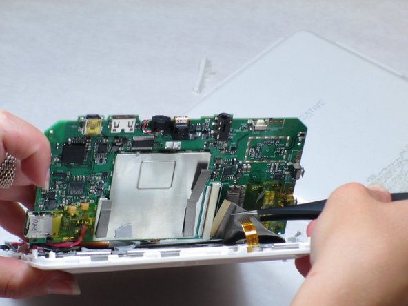

    3. Creative Ziio 7" LCD Screen Replacement: crwdns2935265:04crwdnd2935265:01crwdnd2935265:03crwdne2935265:0 Creative Ziio 7" LCD Screen Replacement: crwdns2935265:04crwdnd2935265:02crwdnd2935265:03crwdne2935265:0 Creative Ziio 7" LCD Screen Replacement: crwdns2935265:04crwdnd2935265:03crwdnd2935265:03crwdne2935265:0
      • Remove the ribbon cable from the exposed side of circuit board near the headphone jack.
      • Carefully lift up the circuit board on the detached side.
      • There is another ribbon cable attached to the underside of the circuit board.
      • Disconnect the second ribbon cable by pulling the end of the ribbon from its housing on the circuit board with tweezers.
      • The circuit board is extremely delicate. Move carefully and don't rush on this step!

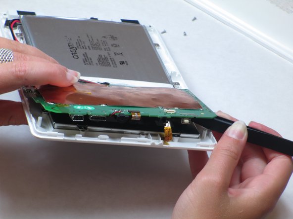

    4. Creative Ziio 7" LCD Screen Replacement: crwdns2935265:05crwdnd2935265:01crwdnd2935265:01crwdne2935265:0
      • On the opposite end of the device: Remove the ribbon cable in between the speakers at the end of the battery.
    5. Creative Ziio 7" LCD Screen Replacement: crwdns2935265:06crwdnd2935265:01crwdnd2935265:01crwdne2935265:0
      • There are three additional 3mm Philips #00 screws underneath the circuit board that need to be removed.
      • Now, remove the battery and circuit board with the LCD attached and turn it over so the screen is facing upwards.

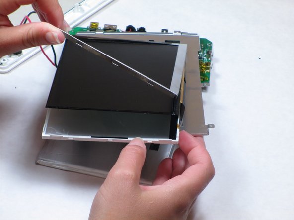

    6. Creative Ziio 7" LCD Screen Replacement: crwdns2935265:07crwdnd2935265:01crwdnd2935265:02crwdne2935265:0 Creative Ziio 7" LCD Screen Replacement: crwdns2935265:07crwdnd2935265:02crwdnd2935265:02crwdne2935265:0
      • Carefully pry the thin, metal frame from around the LCD screen.
      • The frame is extremely thin! Take your time when removing it to avoid bending or deforming it.
    7. Creative Ziio 7" LCD Screen Replacement: crwdns2935265:08crwdnd2935265:01crwdnd2935265:01crwdne2935265:0
      • Carefully remove the black LCD screen.
