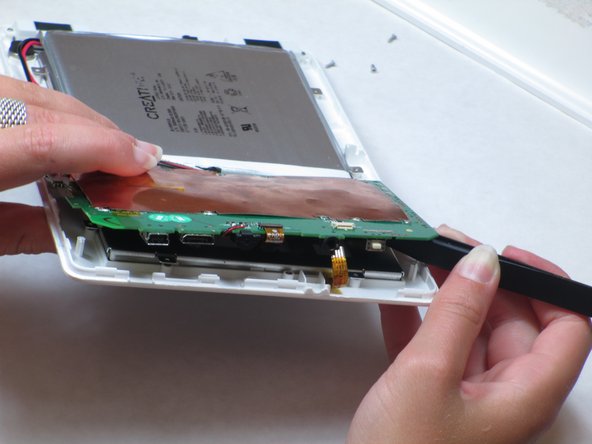

      • Remove the back panel by using the plastic opening tool to carefully pry around the panel's edges.
      • The volume control button and the top power button may fall out during this step.

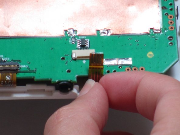

      • Unplug the ribbon cable near the edge of the motherboard in the bottom right of the device.

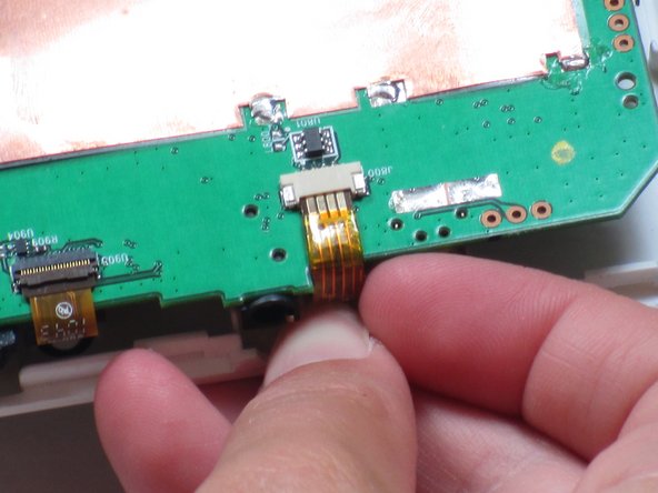

      • Lift up the motherboard.
      • A mesh-like strip on the right side will be connected to the bottom of the motherboard.
      • Remove the tape on top of the strip. Use tweezers or pliers to pull on the strip and unplug it.

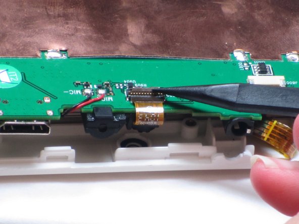

      • Lift up the motherboard and locate the ribbon cable (burnt orange-colored strip) centered on top of the motherboard.
      • The ribbon cable with the attached camera is plugged into the motherboard.
      • Unplug the ribbon cable using your fingers to pull up on the flap.

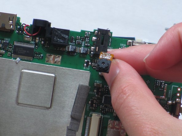

      • Use a spudger to pry the camera away from the rubber camera mount.
      • Do not remove the entire rubber camera mount. Only remove the camera attached with adhesive.
      • Remove the broken camera and use electronic-friendly adhesive to attach a new camera.
