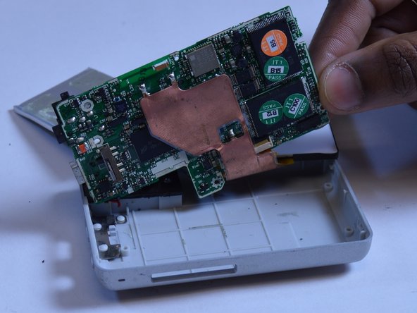

  8. Creative Zen X-Fi LCD Screen Replacement, Pull the Motherboard Out: crwdns2935265:08crwdnd2935265:01crwdnd2935265:02crwdne2935265:0 Creative Zen X-Fi LCD Screen Replacement, Pull the Motherboard Out: crwdns2935265:08crwdnd2935265:02crwdnd2935265:02crwdne2935265:0
    • Lift the right edge of the motherboard off the back case.
    • Using two fingers to grip the edge of the board, slide the motherboard out of the case to the right.

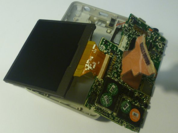

  9. Creative Zen X-Fi LCD Screen Replacement, Disconnect the LCD Screen: crwdns2935265:09crwdnd2935265:01crwdnd2935265:02crwdne2935265:0 Creative Zen X-Fi LCD Screen Replacement, Disconnect the LCD Screen: crwdns2935265:09crwdnd2935265:02crwdnd2935265:02crwdne2935265:0
    • Use two fingers to peel back the edge of the ribbon connector that is glued to the bottom of the LCD screen.
  10. Creative Zen X-Fi LCD Screen Replacement, Unlatch the LCD Screen: crwdns2935265:010crwdnd2935265:01crwdnd2935265:01crwdne2935265:0
    • Using a plastic opening tool, unlock the ribbon connector by unlatching the black lever that pins it on the motherboard.
    • Once the black lever arm is open, pull the ribbon connector out to disconnect the LCD screen.
