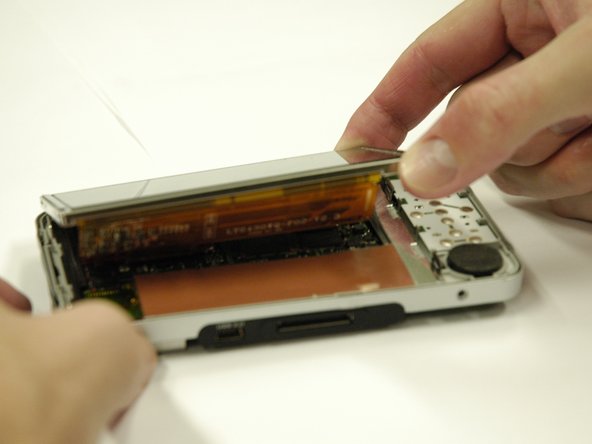

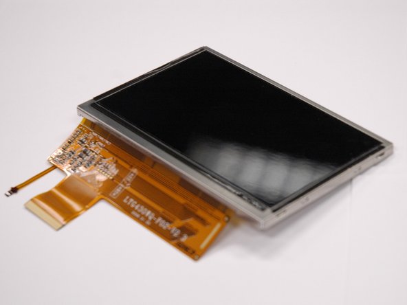

  4. Creative Zen Vision W Motherboard Replacement, LCD Screen: crwdns2935265:04crwdnd2935265:01crwdnd2935265:03crwdne2935265:0 Creative Zen Vision W Motherboard Replacement, LCD Screen: crwdns2935265:04crwdnd2935265:02crwdnd2935265:03crwdne2935265:0 Creative Zen Vision W Motherboard Replacement, LCD Screen: crwdns2935265:04crwdnd2935265:03crwdnd2935265:03crwdne2935265:0
    • Use a spudger to separate the metal tabs that hold the screen in place on the right side.
    • The screen is still attached underneath with two ribbon cables. Lift it very carefully.

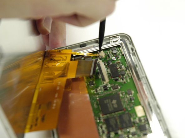

  6. Creative Zen Vision W Motherboard Replacement: crwdns2935265:06crwdnd2935265:01crwdnd2935265:01crwdne2935265:0
    • Use a plastic opening tool to get underneath the black flap on the larger ribbon cable connection and lift it.
  7. Creative Zen Vision W Motherboard Replacement: crwdns2935265:07crwdnd2935265:01crwdnd2935265:03crwdne2935265:0 Creative Zen Vision W Motherboard Replacement: crwdns2935265:07crwdnd2935265:02crwdnd2935265:03crwdne2935265:0 Creative Zen Vision W Motherboard Replacement: crwdns2935265:07crwdnd2935265:03crwdnd2935265:03crwdne2935265:0

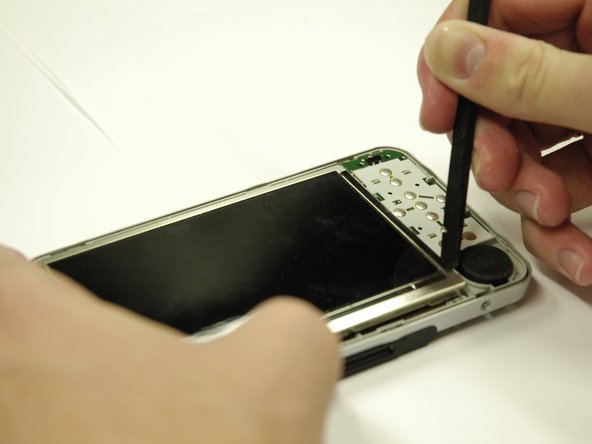

    • Use a spudger to slide the two small gray tabs away from the ribbon cable connection.
    • Remove the screen from the device.

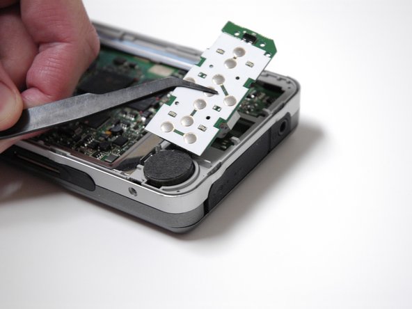

  8. Creative Zen Vision W Motherboard Replacement, Keypad: crwdns2935265:08crwdnd2935265:01crwdnd2935265:01crwdne2935265:0
    • Peel the orange sticker off of the motherboard.
  9. Creative Zen Vision W Motherboard Replacement: crwdns2935265:09crwdnd2935265:01crwdnd2935265:02crwdne2935265:0 Creative Zen Vision W Motherboard Replacement: crwdns2935265:09crwdnd2935265:02crwdnd2935265:02crwdne2935265:0

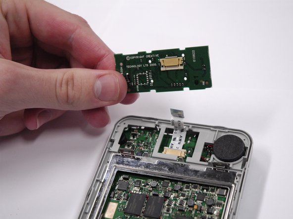

    • Lift the keypad from the left side and use tweezers to slide it out to the left.
  10. Creative Zen Vision W Motherboard Replacement: crwdns2935265:010crwdnd2935265:01crwdnd2935265:02crwdne2935265:0 Creative Zen Vision W Motherboard Replacement: crwdns2935265:010crwdnd2935265:02crwdnd2935265:02crwdne2935265:0
    • Use a small flat head screw driver to slide the white tabs away from the ribbon cable connection.
    • Remove the ribbon cable from the keypad.

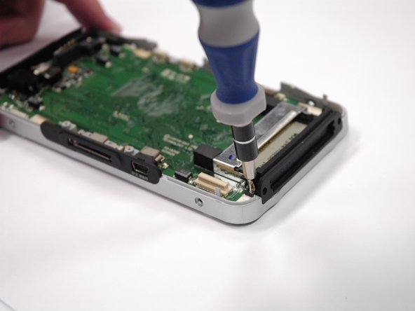

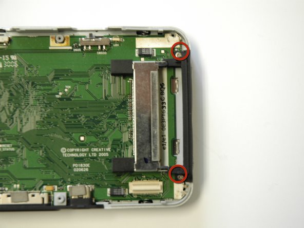

    • Remove 2 screws (3.5 mm) on the black compact flash input using a Phillips #0.
  17. Creative Zen Vision W Motherboard Replacement: crwdns2935265:017crwdnd2935265:01crwdnd2935265:01crwdne2935265:0
    • Use a small flat head screwdriver to bend the plastic tab holding the compact flash input in place.
    • The compact flash input should pop off easily, be careful not to break it.

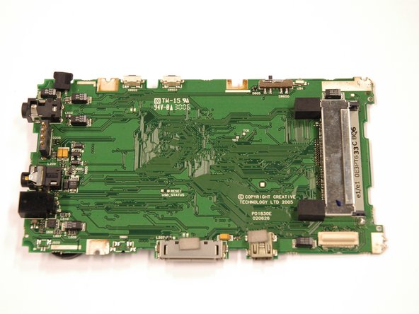

  18. Creative Zen Vision W Motherboard Replacement: crwdns2935265:018crwdnd2935265:01crwdnd2935265:01crwdne2935265:0
    • Turn the device over so the side where the screen was is facing up.
    • Push on the motherboard lightly to separate it from the casing.

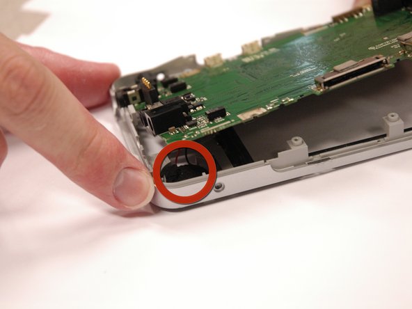

  19. Creative Zen Vision W Motherboard Replacement: crwdns2935265:019crwdnd2935265:01crwdnd2935265:02crwdne2935265:0 Creative Zen Vision W Motherboard Replacement: crwdns2935265:019crwdnd2935265:02crwdnd2935265:02crwdne2935265:0
    • Turn the device over again and pull on the motherboard very lightly.
    • The speaker will be covered in a black glue and you must cut through this in order to remove the motherboard.
  20. Creative Zen Vision W Motherboard Replacement: crwdns2935265:020crwdnd2935265:01crwdnd2935265:01crwdne2935265:0
    • Turn the speaker on its side so it can fit through the casing and the motherboard can be removed.
  21. Creative Zen Vision W Motherboard Replacement: crwdns2935265:021crwdnd2935265:01crwdnd2935265:02crwdne2935265:0 Creative Zen Vision W Motherboard Replacement: crwdns2935265:021crwdnd2935265:02crwdnd2935265:02crwdne2935265:0
    • You have now removed the motherboard.
    • Speaker
