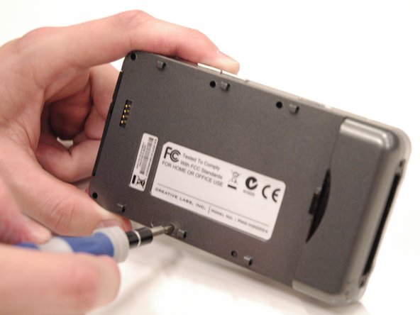

  2. Creative Zen Vision W Hard Drive Replacement, Back Cover: crwdns2935265:02crwdnd2935265:01crwdnd2935265:01crwdne2935265:0
    • Remove the 2 screws (3.5 mm) on the Compact Flash insert, located on the left hand side, with a Phillips #000 screwdriver.

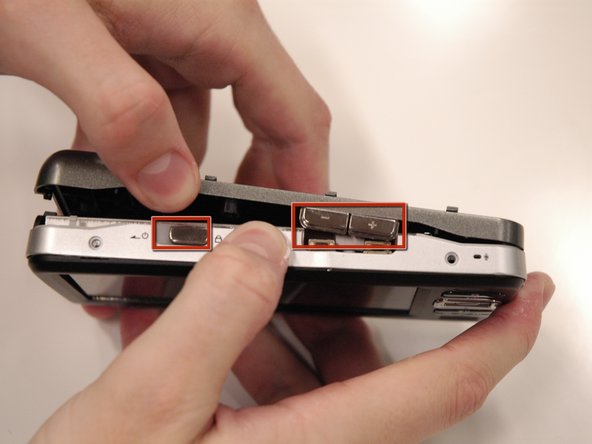

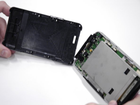

  4. Creative Zen Vision W Hard Drive Replacement: crwdns2935265:04crwdnd2935265:01crwdnd2935265:03crwdne2935265:0 Creative Zen Vision W Hard Drive Replacement: crwdns2935265:04crwdnd2935265:02crwdnd2935265:03crwdne2935265:0 Creative Zen Vision W Hard Drive Replacement: crwdns2935265:04crwdnd2935265:03crwdnd2935265:03crwdne2935265:0
    • Carefully pull the back cover off of the rest of the device.
    • The volume control buttons and power slider may fall off when removing the cover, do not lose these small pieces.
    • The USB input cover on the bottom of the device may also fall off.

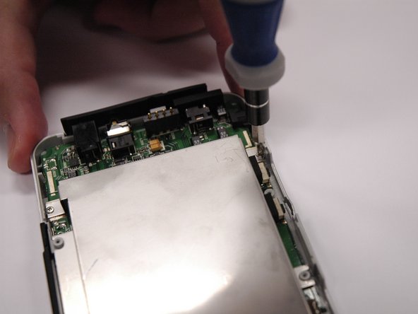

  5. Creative Zen Vision W Hard Drive Replacement, Hard Drive: crwdns2935265:05crwdnd2935265:01crwdnd2935265:02crwdne2935265:0 Creative Zen Vision W Hard Drive Replacement, Hard Drive: crwdns2935265:05crwdnd2935265:02crwdnd2935265:02crwdne2935265:0
    • Remove 4 screws (3.5 mm) on the metal cover with a Phillips #0.
    • Lift the metal cover off.

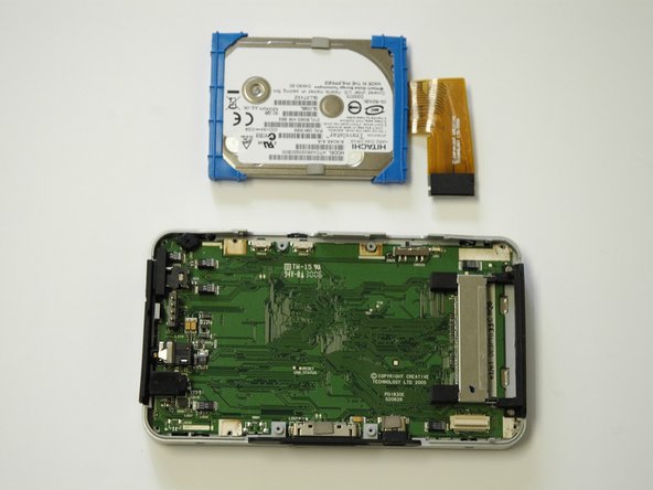

  6. Creative Zen Vision W Hard Drive Replacement: crwdns2935265:06crwdnd2935265:01crwdnd2935265:03crwdne2935265:0 Creative Zen Vision W Hard Drive Replacement: crwdns2935265:06crwdnd2935265:02crwdnd2935265:03crwdne2935265:0 Creative Zen Vision W Hard Drive Replacement: crwdns2935265:06crwdnd2935265:03crwdnd2935265:03crwdne2935265:0
    • Lift the white and black ribbon connection off of the motherboard.
    • The hard drive can now be removed.
