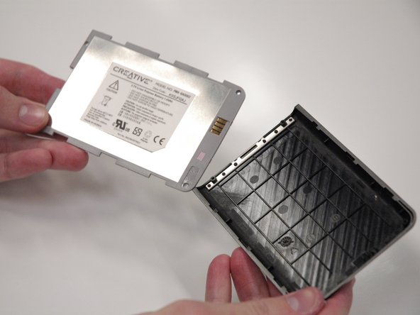

      • Push the black button and slide the battery casing to the left simultaneously, until the battery is completely separated from the device.
    1. Creative Zen Vision W Battery Replacement, Battery: crwdns2935265:02crwdnd2935265:01crwdnd2935265:02crwdne2935265:0 Creative Zen Vision W Battery Replacement, Battery: crwdns2935265:02crwdnd2935265:02crwdnd2935265:02crwdne2935265:0
      • Remove the three 4 mm exposed screws using a Phillips #0 screwdriver.
      • Peel off the the sticker that says "Creative Warranty Void if broken" and remove the 4 mm screw beneath with a Phillips #0 screwdriver.
    2. Creative Zen Vision W Battery Replacement: crwdns2935265:03crwdnd2935265:01crwdnd2935265:03crwdne2935265:0 Creative Zen Vision W Battery Replacement: crwdns2935265:03crwdnd2935265:02crwdnd2935265:03crwdne2935265:0 Creative Zen Vision W Battery Replacement: crwdns2935265:03crwdnd2935265:03crwdnd2935265:03crwdne2935265:0

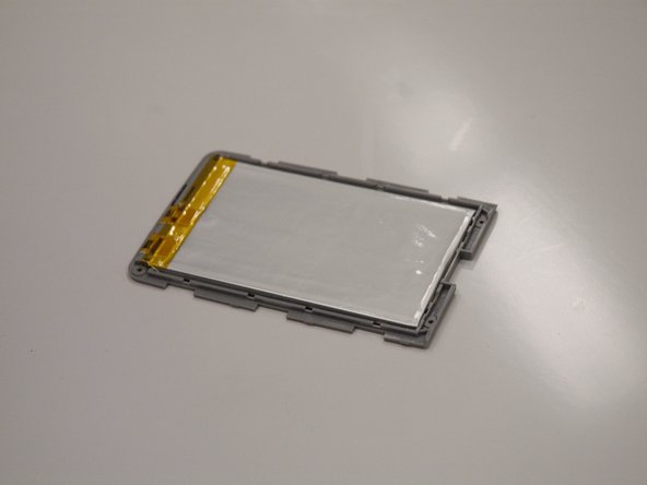

      • Remove the battery from the casing by bending the sides. The battery should pop out. Be careful not to snap the case.
Follow these instructions in reverse order to reassemble your device.
