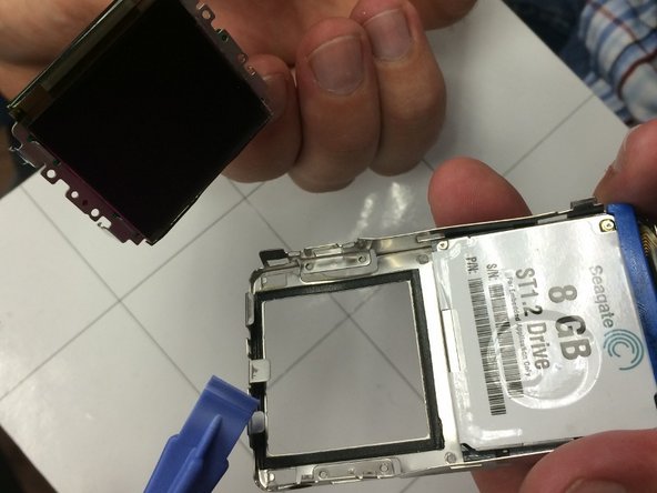

  11. Creative Zen Microphoto Screen Replacement, Removing the Screws from the Screen: crwdns2935265:011crwdnd2935265:01crwdnd2935265:01crwdne2935265:0
    • Using a screwdriver, remove four Philip screws from the back of the screen.
    • Place the four screws in a small baggy for later reassembly.
  12. Creative Zen Microphoto Screen Replacement, Detaching the Hard Drive from the Main Board: crwdns2935265:012crwdnd2935265:01crwdnd2935265:01crwdne2935265:0
    • Carefully pull out the gold piece from the top of the hard drive.
  13. Creative Zen Microphoto Screen Replacement, Removing the Screen from the Device: crwdns2935265:013crwdnd2935265:01crwdnd2935265:02crwdne2935265:0 Creative Zen Microphoto Screen Replacement, Removing the Screen from the Device: crwdns2935265:013crwdnd2935265:02crwdnd2935265:02crwdne2935265:0
    • Carefully use your thumbs to pull out the screen (that is below the hard drive).

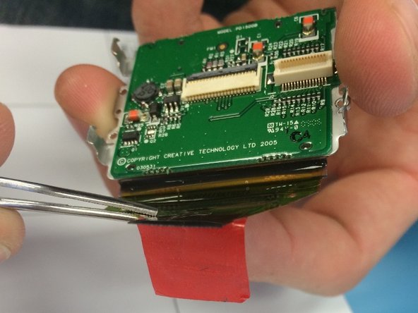

  15. Creative Zen Microphoto Screen Replacement, Pulling Down the Red Strip of the Screen: crwdns2935265:015crwdnd2935265:01crwdnd2935265:01crwdne2935265:0
    • With tweezers, lightly pull down on red strip in the middle of the back of the screen.
  16. Creative Zen Microphoto Screen Replacement, Detaching the Red Strip from the Back of the Screen: crwdns2935265:016crwdnd2935265:01crwdnd2935265:02crwdne2935265:0 Creative Zen Microphoto Screen Replacement, Detaching the Red Strip from the Back of the Screen: crwdns2935265:016crwdnd2935265:02crwdnd2935265:02crwdne2935265:0
    • With the tweezers, carefully pull the red strip off of the back of the screen.
    • DO NOT FULLY DETACH THE TAB FROM THE DEVICE.

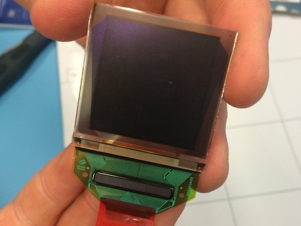

  17. Creative Zen Microphoto Screen Replacement, Removing the Screen from the Device: crwdns2935265:017crwdnd2935265:01crwdnd2935265:02crwdne2935265:0 Creative Zen Microphoto Screen Replacement, Removing the Screen from the Device: crwdns2935265:017crwdnd2935265:02crwdnd2935265:02crwdne2935265:0
    • Carefully lift up the two pieces of the screen to reveal the actual back of the screen.
    • Pull out the screen from the device.

Great way to destroy a Zen. Don’t pry the front off. Slide the metal cover under the battery down away from the contacts so that the tabs beside the battery contacts disengage, then press on the lower part of the battery compartment while holding the front. This keeps you from ripping the touch pad connector off and you can access everything with the front panel still glued on. Just proceed to remove the rear cover, then remove the motherboard, and you have access to the screen.
