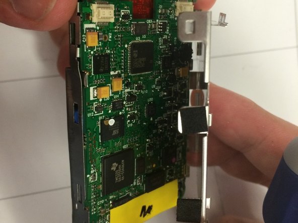

  7. Creative Zen MicroPhoto Motherboard Replacement, Taking off the Back Cover of the Main Board: crwdns2935265:07crwdnd2935265:01crwdnd2935265:02crwdne2935265:0 Creative Zen MicroPhoto Motherboard Replacement, Taking off the Back Cover of the Main Board: crwdns2935265:07crwdnd2935265:02crwdnd2935265:02crwdne2935265:0
    • No tools are needed. The prongs (pictured) will release easily to remove the back cover.
    • Carefully remove the back cover.

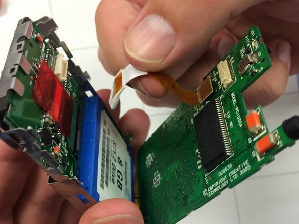

  8. Creative Zen MicroPhoto Motherboard Replacement, Removing the Main Board from the Screen: crwdns2935265:08crwdnd2935265:01crwdnd2935265:01crwdne2935265:0
    • Be gentle when removing the main board. The main board is attached to the front panel of the device by wires.
    • Using the flat-head screwdriver, carefully pry open the prongs on the sides of the device, and remove the main board from the screen.

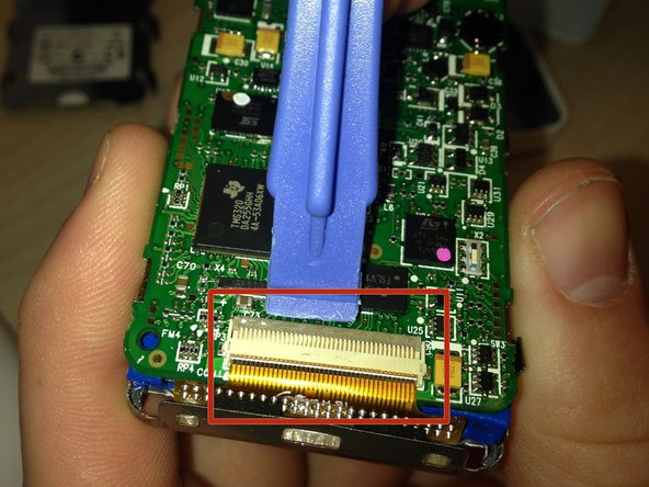

  9. Creative Zen MicroPhoto Motherboard Replacement, Removing the Main Board from the Device: crwdns2935265:09crwdnd2935265:01crwdnd2935265:03crwdne2935265:0 Creative Zen MicroPhoto Motherboard Replacement, Removing the Main Board from the Device: crwdns2935265:09crwdnd2935265:02crwdnd2935265:03crwdne2935265:0 Creative Zen MicroPhoto Motherboard Replacement, Removing the Main Board from the Device: crwdns2935265:09crwdnd2935265:03crwdnd2935265:03crwdne2935265:0
    • Do not damage the ribbon tab (pictured). It is vital to the device.
    • Push the ribbon tab (sticking out below the main screen) backward through the square hole to remove the main board of the device.
    • Once the wiring is removed from the front panel, release the hinge at the bottom of the device. To do so, gently pry underneath the clip (pictured) with a plastic opening tool. The clip will pop up, and the motherboard can be completely removed.
