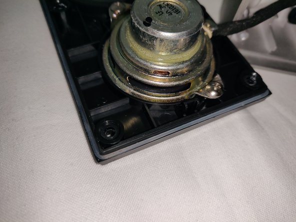

      • Remove all screws from the black front using a long PH screwdriver.
    3. Creative MUVO 2 Battery Replacement, Unplug speaker assembly: crwdns2935265:03crwdnd2935265:01crwdnd2935265:02crwdne2935265:0 Creative MUVO 2 Battery Replacement, Unplug speaker assembly: crwdns2935265:03crwdnd2935265:02crwdnd2935265:02crwdne2935265:0
      • Carefully unplug the cable that connects the speakers to the circuit board.

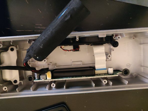

    4. Creative MUVO 2 Battery Replacement, unscrew battery attachment: crwdns2935265:04crwdnd2935265:01crwdnd2935265:03crwdne2935265:0 Creative MUVO 2 Battery Replacement, unscrew battery attachment: crwdns2935265:04crwdnd2935265:02crwdnd2935265:03crwdne2935265:0 Creative MUVO 2 Battery Replacement, unscrew battery attachment: crwdns2935265:04crwdnd2935265:03crwdnd2935265:03crwdne2935265:0
      • Unscrew and remove the black plastic part that attaches the battery to the back of the case.

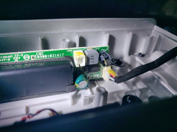

    5. Creative MUVO 2 Battery Replacement, unplug battery: crwdns2935265:05crwdnd2935265:01crwdnd2935265:01crwdne2935265:0
      • Li-Ion Batteries can catch fire and explode if they are being mishandled! (e.g. when they are short-circuited or physically damaged).
      • Unplug the battery from the circuit board. You might have to use a knife or some other tool to remove the glue that is on the connector.

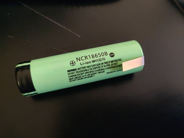

      • Get a new 18650 battery. I bought an expensive one from Panasonic. Be sure to spend some money in order to get a genuine one, and make sure to buy one that contains extra protection circuitry and solder tabs!
      • Sorry for the lack of pictures: Basically you have to improvise a bit. solder the cable with the plug somehow to the battery's solder tabs. Be sure to have the correct polarity! Also use plenty of sticky tape to protect everything from causing short circuits!

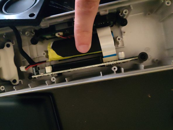

      • Finally, take the blue cushion-wrapping and somehow try to wrap it around the battery. Then try to attach the battery to the case using the black plastic brace and the two screws.
      • Carefully plug the battery-plug into the main circuit board and check that nothing starts to heat up or even cause smoke. In which case you have probably messed up.
      • Connect the speakers and switch the device on. If everything works, put everything back together.
