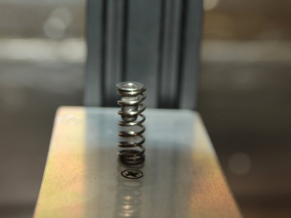

    • Remove the screw holding the spring in place.
    • Also, before going any further, remove the PFTE tubing from the assembly.
  3. Creality Ender 3 Extruder Motor Assembly Replacement: crwdns2935265:03crwdnd2935265:01crwdnd2935265:02crwdne2935265:0 Creality Ender 3 Extruder Motor Assembly Replacement: crwdns2935265:03crwdnd2935265:02crwdnd2935265:02crwdne2935265:0
    • Once the screw is removed, take out the spring and the small metal bracket inside.
    • Once you are done, recall how the spring and bracket are put together.
