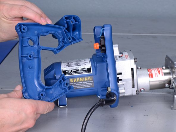

  2. Crain Jamb Saw 775 2014 Switch Replacement, Remove the housing bracket: crwdns2935265:02crwdnd2935265:01crwdnd2935265:01crwdne2935265:0
    • Remove the metal housing bracket.
  3. Crain Jamb Saw 775 2014 Switch Replacement, Remove the saw housing: crwdns2935265:03crwdnd2935265:01crwdnd2935265:02crwdne2935265:0 Crain Jamb Saw 775 2014 Switch Replacement, Remove the saw housing: crwdns2935265:03crwdnd2935265:02crwdnd2935265:02crwdne2935265:0
    • Remove the saw housing.

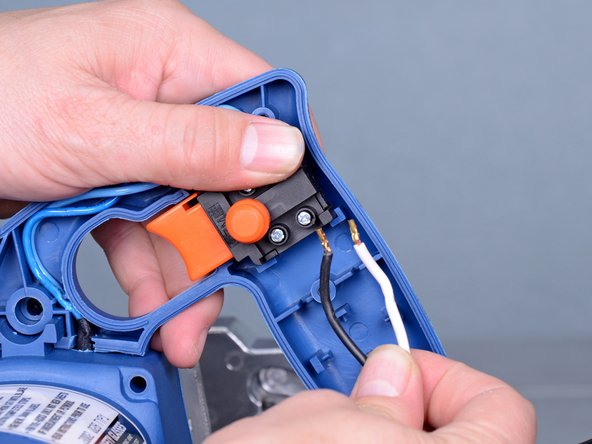

  4. Crain Jamb Saw 775 2014 Switch Replacement, Unfasten the switch wires: crwdns2935265:04crwdnd2935265:01crwdnd2935265:01crwdne2935265:0
    • Use a Phillips #2 screwdriver to loosen the four screw terminals securing the power cord and motor wires.
    • Take note of which wire connects to which terminal for reassembly purposes.
    • The switch is not secured to the housing; be sure to hold it in place when removing the motor and power cord wires.
  5. Crain Jamb Saw 775 2014 Switch Replacement, Disconnect the power cord wires: crwdns2935265:05crwdnd2935265:01crwdnd2935265:02crwdne2935265:0 Crain Jamb Saw 775 2014 Switch Replacement, Disconnect the power cord wires: crwdns2935265:05crwdnd2935265:02crwdnd2935265:02crwdne2935265:0
    • Remove the power cord wires from the main switch.

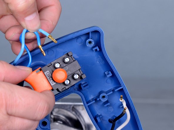

  6. Crain Jamb Saw 775 2014 Switch Replacement, Disconnect the motor wires: crwdns2935265:06crwdnd2935265:01crwdnd2935265:02crwdne2935265:0 Crain Jamb Saw 775 2014 Switch Replacement, Disconnect the motor wires: crwdns2935265:06crwdnd2935265:02crwdnd2935265:02crwdne2935265:0
    • Remove the motor wires from the switch.
  7. Crain Jamb Saw 775 2014 Switch Replacement, Remove the switch: crwdns2935265:07crwdnd2935265:01crwdnd2935265:01crwdne2935265:0
    • Remove the switch.
