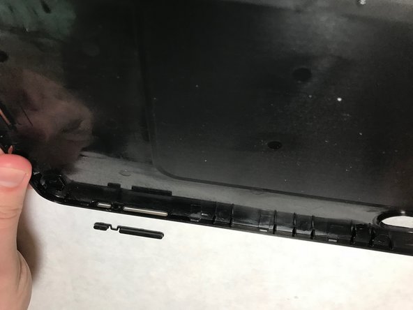

  4. Craig Electronics CMP773 Volume/Power Control Button Replacement: crwdns2935265:04crwdnd2935265:01crwdnd2935265:01crwdne2935265:0
    • On the back cover, find the location where the volume/power button is held.
    • The volume/power button is not held securely after back is removed so it may fall out of place while removing the back cover from the device.
  5. Craig Electronics CMP773 Volume/Power Control Button Replacement: crwdns2935265:05crwdnd2935265:01crwdnd2935265:02crwdne2935265:0 Craig Electronics CMP773 Volume/Power Control Button Replacement: crwdns2935265:05crwdnd2935265:02crwdnd2935265:02crwdne2935265:0
    • Remove the old button and replace it with the new one.
Once the above steps have been successfully competed, power on the device. Enjoy your newly replaced volume/power control button.
