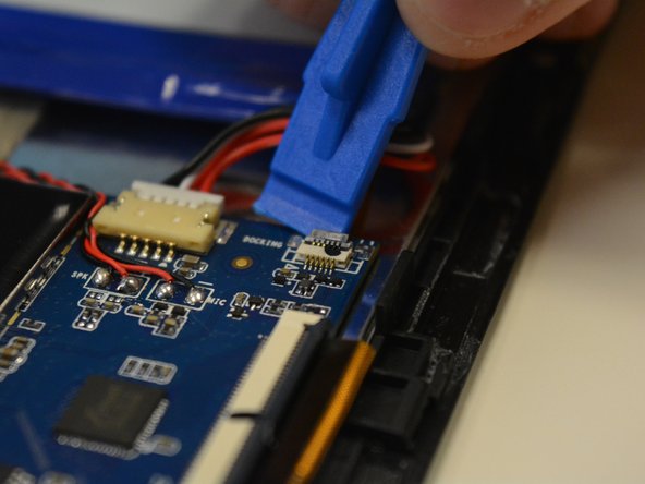

  4. Craig CMP801 LCD Screen Replacement, Volume Controls: crwdns2935265:04crwdnd2935265:01crwdnd2935265:02crwdne2935265:0 Craig CMP801 LCD Screen Replacement, Volume Controls: crwdns2935265:04crwdnd2935265:02crwdnd2935265:02crwdne2935265:0
    • After taking out the back cover, locate the black flap.
    • Open the black flap with the plastic opening tools.
    • Be careful not to break the flap when you open it.

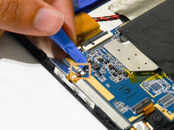

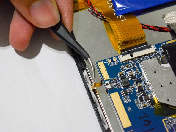

  5. Craig CMP801 LCD Screen Replacement: crwdns2935265:05crwdnd2935265:01crwdnd2935265:02crwdne2935265:0 Craig CMP801 LCD Screen Replacement: crwdns2935265:05crwdnd2935265:02crwdnd2935265:02crwdne2935265:0
    $3.99
    • Once the tab is released, use the angled tweezers to take out the tab.
    • Be careful not to scratch the tab.

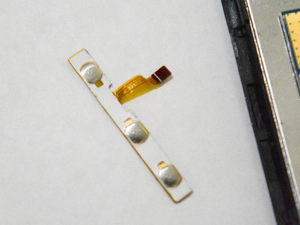

  6. Craig CMP801 LCD Screen Replacement: crwdns2935265:06crwdnd2935265:01crwdnd2935265:02crwdne2935265:0 Craig CMP801 LCD Screen Replacement: crwdns2935265:06crwdnd2935265:02crwdnd2935265:02crwdne2935265:0
    • Use the angled tweezers to pull the volume controls out and replace it with a new one.

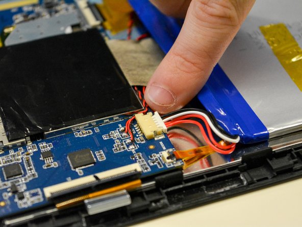

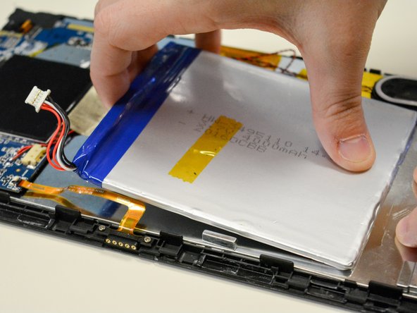

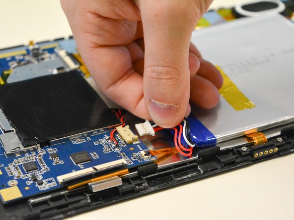

  7. Craig CMP801 LCD Screen Replacement, Battery: crwdns2935265:07crwdnd2935265:01crwdnd2935265:03crwdne2935265:0 Craig CMP801 LCD Screen Replacement, Battery: crwdns2935265:07crwdnd2935265:02crwdnd2935265:03crwdne2935265:0 Craig CMP801 LCD Screen Replacement, Battery: crwdns2935265:07crwdnd2935265:03crwdnd2935265:03crwdne2935265:0
    • Locate the white plug next to the battery.
    • Use your fingers to pull off white plug that connected to the battery.
    • Be careful not to pull or break the wires on the bottom.

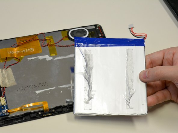

  8. Craig CMP801 LCD Screen Replacement: crwdns2935265:08crwdnd2935265:01crwdnd2935265:03crwdne2935265:0 Craig CMP801 LCD Screen Replacement: crwdns2935265:08crwdnd2935265:02crwdnd2935265:03crwdne2935265:0 Craig CMP801 LCD Screen Replacement: crwdns2935265:08crwdnd2935265:03crwdnd2935265:03crwdne2935265:0
    • The battery should only be connected to the LCD by adhesive tape.
    • Using force, carefully remove the battery while holding the LCD in place.

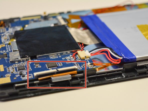

  9. Craig CMP801 LCD Screen Replacement, LCD Screen: crwdns2935265:09crwdnd2935265:01crwdnd2935265:03crwdne2935265:0 Craig CMP801 LCD Screen Replacement, LCD Screen: crwdns2935265:09crwdnd2935265:02crwdnd2935265:03crwdne2935265:0 Craig CMP801 LCD Screen Replacement, LCD Screen: crwdns2935265:09crwdnd2935265:03crwdnd2935265:03crwdne2935265:0

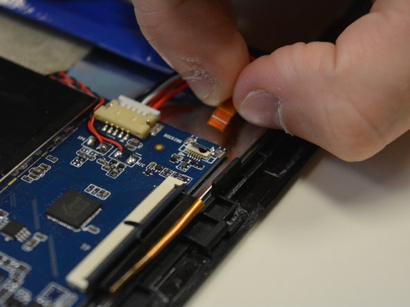

    • Open the three black flaps located on each side of the motherboard.
  10. Craig CMP801 LCD Screen Replacement: crwdns2935265:010crwdnd2935265:01crwdnd2935265:02crwdne2935265:0 Craig CMP801 LCD Screen Replacement: crwdns2935265:010crwdnd2935265:02crwdnd2935265:02crwdne2935265:0
    • Then detach each of the three tabs from the LCD screen.

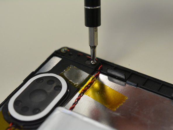

    • Using a Philips 0 Screwdriver, remove the screws connecting the speaker to the motherboard.
    • Remove black plastic speaker holder.

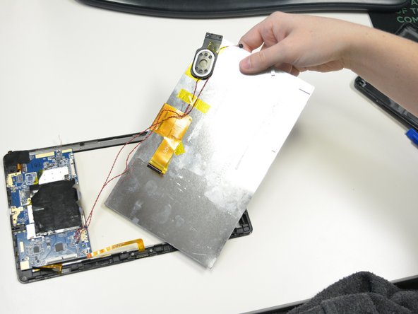

  13. Craig CMP801 LCD Screen Replacement: crwdns2935265:013crwdnd2935265:01crwdnd2935265:02crwdne2935265:0 Craig CMP801 LCD Screen Replacement: crwdns2935265:013crwdnd2935265:02crwdnd2935265:02crwdne2935265:0
    • Carefully slide out the metal slate and LCD screen from underneath the motherboard.
  14. Craig CMP801 LCD Screen Replacement: crwdns2935265:014crwdnd2935265:01crwdnd2935265:01crwdne2935265:0
    • Flip over the metal slate and separate the LCD screen from it.
