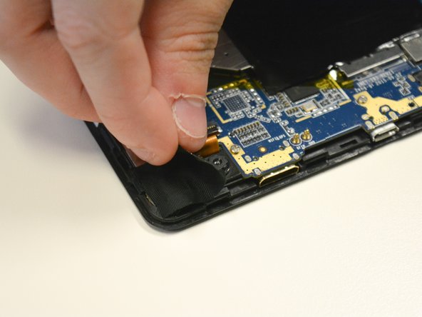

    • Once the back cover is removed, gently remove the black tape that covers the front and rear facing camera.

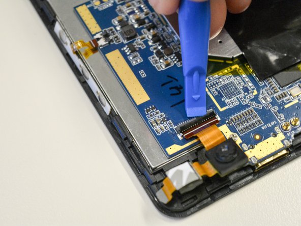

    • Near the edge of the device, lift up the tab connected to the front-facing camera.
  6. Craig CMP801 Front and Rear Facing Camera Replacement: crwdns2935265:06crwdnd2935265:01crwdnd2935265:02crwdne2935265:0 Craig CMP801 Front and Rear Facing Camera Replacement: crwdns2935265:06crwdnd2935265:02crwdnd2935265:02crwdne2935265:0
    • Locate the black flap that covers and holds down the tab connected to the rear-facing camera.
    • Flip the flap up to release the tab.

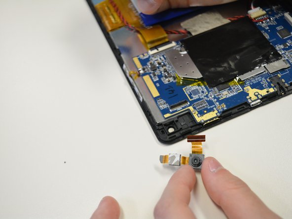

    • Gently pull on the tab connected to the front-facing camera to release both the front and rear-facing cameras.
