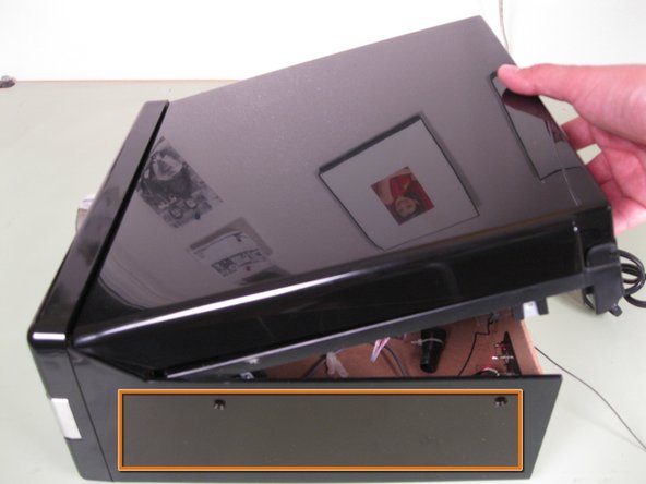

    • Gently pull up on the back of the turntable while pulling back.
    • Do not lift up too high. There are cables inside attached to the turntable.
    • Place the entire radio on its right side and lower the turntable. The orange box indicates which side is the right side.

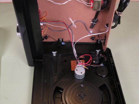

  4. Craig CD681 Speakers Replacement: crwdns2935265:04crwdnd2935265:01crwdnd2935265:03crwdne2935265:0 Craig CD681 Speakers Replacement: crwdns2935265:04crwdnd2935265:02crwdnd2935265:03crwdne2935265:0 Craig CD681 Speakers Replacement: crwdns2935265:04crwdnd2935265:03crwdnd2935265:03crwdne2935265:0
    • Unwind the black strap wrapped around the cables connected to the turntable.
    • Remove the two plastic connectors attached to the circuit board on the turntable.
    • The plastic connectors are called Molex connectors.
    • Untie the two knots keeping the antenna cable in place and pull the cable into the radio's body.
