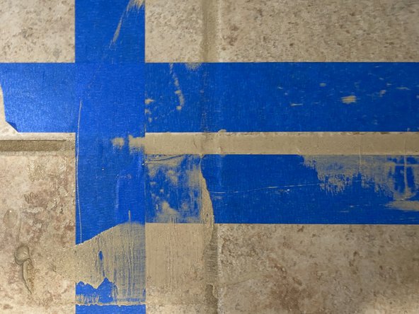

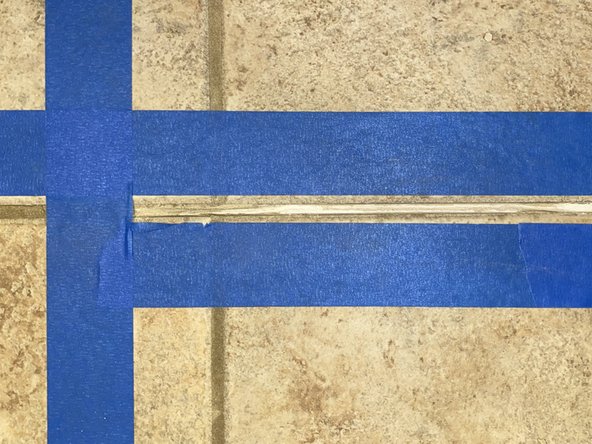

    • Identify the crack you will be repairing.
    • Surround it with Painters Tape.

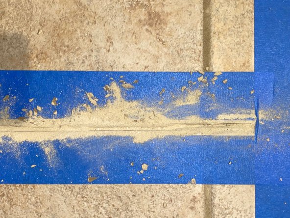

  3. Cracked Grout Replacement: crwdns2935265:03crwdnd2935265:01crwdnd2935265:02crwdne2935265:0 Cracked Grout Replacement: crwdns2935265:03crwdnd2935265:02crwdnd2935265:02crwdne2935265:0
    • Wear protective eye wear and a mask to shield yourself from dust and debris.
    • Go in with your handheld grout remover and scrape out the remaining grout between the tile until it is completely hollow.

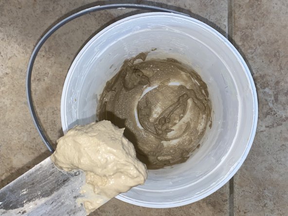

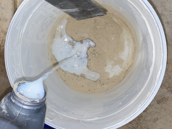

  6. Cracked Grout Replacement: crwdns2935265:06crwdnd2935265:01crwdnd2935265:03crwdne2935265:0 Cracked Grout Replacement: crwdns2935265:06crwdnd2935265:02crwdnd2935265:03crwdne2935265:0 Cracked Grout Replacement: crwdns2935265:06crwdnd2935265:03crwdnd2935265:03crwdne2935265:0
    • Mix a scoop of grout and sealer to create a paste.

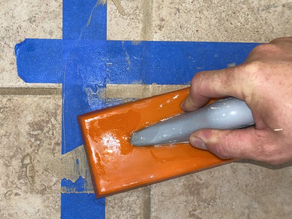

  7. Cracked Grout Replacement: crwdns2935265:07crwdnd2935265:01crwdnd2935265:03crwdne2935265:0 Cracked Grout Replacement: crwdns2935265:07crwdnd2935265:02crwdnd2935265:03crwdne2935265:0 Cracked Grout Replacement: crwdns2935265:07crwdnd2935265:03crwdnd2935265:03crwdne2935265:0
    • Take the rubber grout float and press the grout paste securely into the crack.

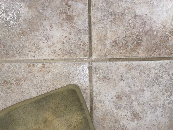

  8. Cracked Grout Replacement: crwdns2935265:08crwdnd2935265:01crwdnd2935265:02crwdne2935265:0 Cracked Grout Replacement: crwdns2935265:08crwdnd2935265:02crwdnd2935265:02crwdne2935265:0
    • Take the grouting sponge and smooth out the grout evenly.
    • Let the grout sit and harden for twenty-four hours.
