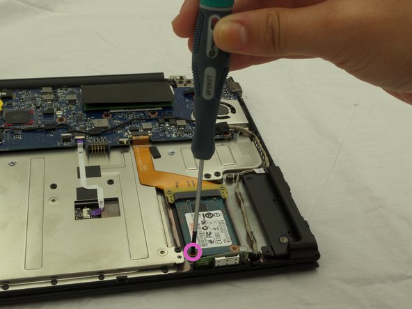

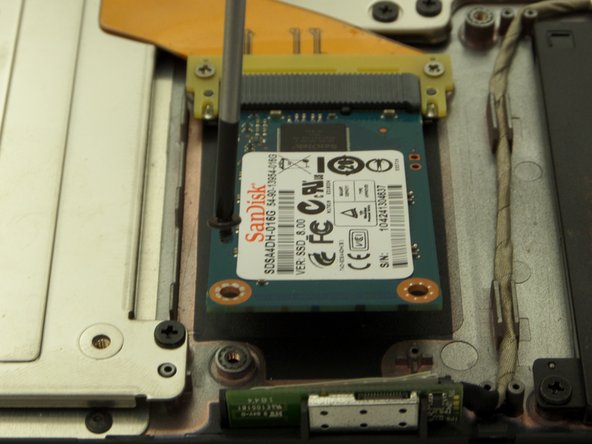

  5. Cr-48 Chromebook SSD Replacement, Locate SSD and Remove Screw: crwdns2935265:05crwdnd2935265:01crwdnd2935265:03crwdne2935265:0 Cr-48 Chromebook SSD Replacement, Locate SSD and Remove Screw: crwdns2935265:05crwdnd2935265:02crwdnd2935265:03crwdne2935265:0 Cr-48 Chromebook SSD Replacement, Locate SSD and Remove Screw: crwdns2935265:05crwdnd2935265:03crwdnd2935265:03crwdne2935265:0
    • Find the SSD located on a corner of the side directly opposite where the laptop screen and device body are connected.
    • Remove one black screw on the SSD using a PH #00 screwdriver.
    • Size ph#00, approximately 3 mm long.
    • Once unscrewed, the SSD will pop up from the device.

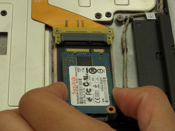

  6. Cr-48 Chromebook SSD Replacement, Remove SSD: crwdns2935265:06crwdnd2935265:01crwdnd2935265:02crwdne2935265:0 Cr-48 Chromebook SSD Replacement, Remove SSD: crwdns2935265:06crwdnd2935265:02crwdnd2935265:02crwdne2935265:0
    • Firmly grasp the SSD with two fingers slightly upwards and pull.
