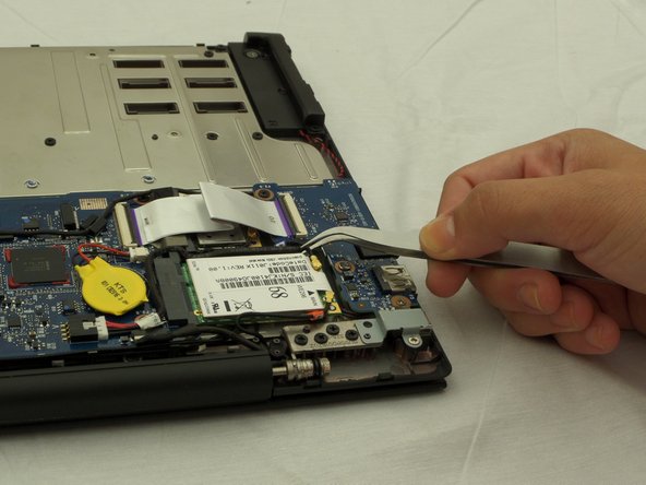

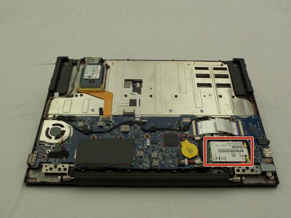

  5. Cr-48 Chromebook Network Card Replacement, Identify the Network Card and Remove the Connectors: crwdns2935265:05crwdnd2935265:01crwdnd2935265:03crwdne2935265:0 Cr-48 Chromebook Network Card Replacement, Identify the Network Card and Remove the Connectors: crwdns2935265:05crwdnd2935265:02crwdnd2935265:03crwdne2935265:0 Cr-48 Chromebook Network Card Replacement, Identify the Network Card and Remove the Connectors: crwdns2935265:05crwdnd2935265:03crwdnd2935265:03crwdne2935265:0
    • Once you've removed the lower case, you should see the network card on the corner of the device containing the USB port.
    • Disconnect the Wire connections on the network card using forceps or tweezers.

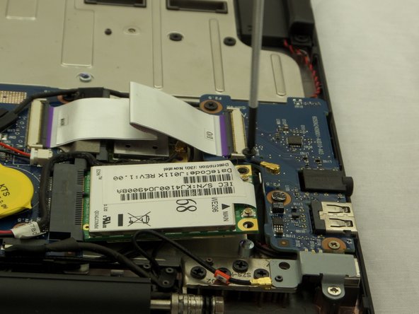

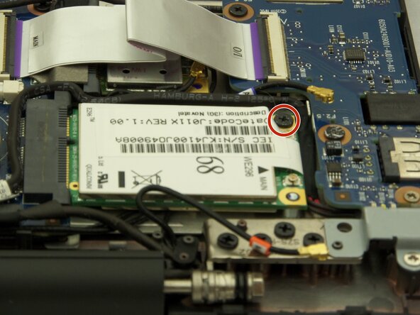

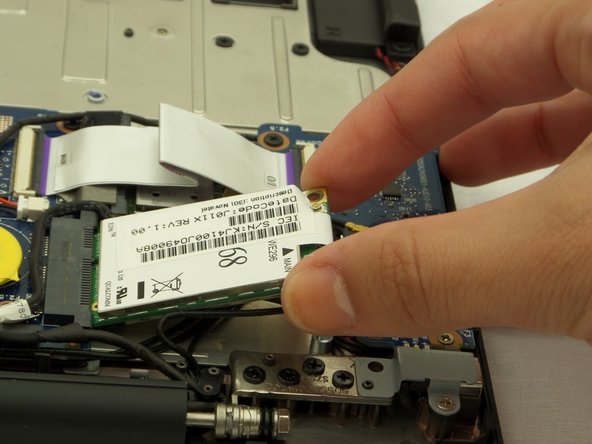

  6. Cr-48 Chromebook Network Card Replacement, Unscrew and Remove Network Card: crwdns2935265:06crwdnd2935265:01crwdnd2935265:03crwdne2935265:0 Cr-48 Chromebook Network Card Replacement, Unscrew and Remove Network Card: crwdns2935265:06crwdnd2935265:02crwdnd2935265:03crwdne2935265:0 Cr-48 Chromebook Network Card Replacement, Unscrew and Remove Network Card: crwdns2935265:06crwdnd2935265:03crwdnd2935265:03crwdne2935265:0
    • Remove the screw (about 3 mm in length) securing the network card.
    • Once the screw is removed, the network card will pop up.
    • Pull the network card to remove it from the device.

The card identified in the pictures is not a combined Wi-Fi / Cellular card. It is just a 3G cellular card; the WiFi card is the other card tucked under the flat ribbon next to the card pictured in this guide
